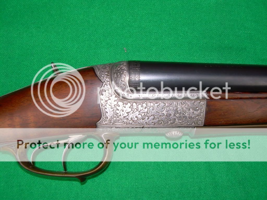

Hello Gentlemen:
I am looking for related information and, if possible, aproximate value of a really interesting shotgun.
It belongs to a friend of mine, here in Mexico city, and we will apreciate if some of you can upload the photos I have. Belive me it is worth the effort, so if any of you can help to show the photos in the forum (send them to an e-mail) it will be great.
The shotgun is German, side by side, with a very rare locking system and also a unusual safety. It is in very nice condition (like new I think).
This is the information I have:
Wilh. Collath-Sohne
Franfurt
A- Oder
Witten Tesco Excelsior
It is a 12 ga, 70 mm, with 75 cm barrels and extractors, choked extrafull both sides. The photos will tell a lot more.
Thank you in advance for the helping to upload the photos and the knowlege comments you will do.
Jose M. Fernandez

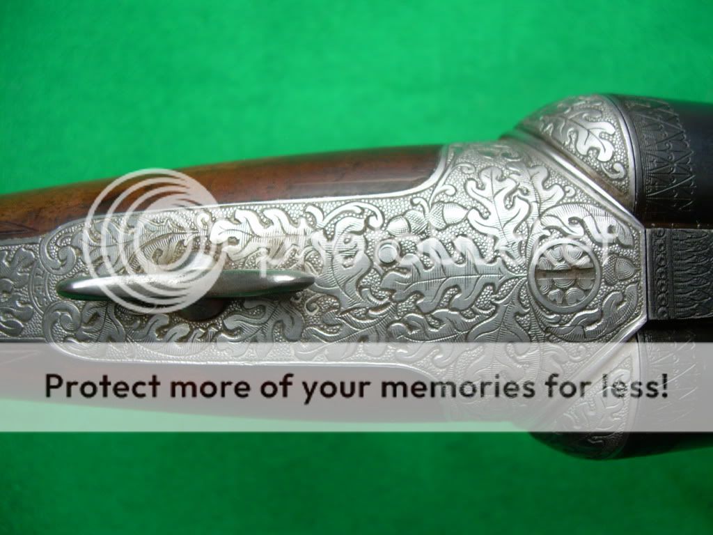

More pics and I hope better resolution than my 1st attempt. Very nice oak leaf engraving throughout.

A few questions:
Do somebody know about the history of the maker?
Does the locking system has a name?
Also, does the unusual safety has a particular name?
The tigerguard and the front lever are made of some kind of horn.
Can I say for sure that the shotgun was made in the 1920´s?
Some guess of value in your Country?
I fall in love with this shotgun since I met her yesterday. So rare and so beautifull; perhaps not very shotable with those extrafull chokes.
Jose M. Fernandez

A cutaway showing the safety from KCordell's thread: http://www.doublegunshop.com/forums/ubbthreads.php?ubb=showflat&Number=184857&page=1
Jose:
When does the tab beside the wing safety rise and is there stamped "nes" under the lower wing? And there looks to be some interesting mark on the tubes just forward of the flats, that is if if isn't a mesh of scratches.

Re. cutaway. I had Tesco double 16G circa 1928 and locks design was a bit different. First of all firing pins were thick and long inside the action and when wing safety turns accentric wheel pushes both hammers a bit back from firing pins. Flat spring, that looks like two points fork been placed right to the trigger plate by one screw bolt.
No NES signs was on mine.
Geno.

About the NES word in the bottom of the safety, NO, there is no such word (or any other) in that area.
I am sorry but I do not understand well your last question: do you want that I take a better picture of the barrel flats to see the marks?
My friend, the owner, wants to use the shotgun (basically for quail hunting) so he is adapting a detechable comb rising and increasing the lenght of pull (without altering the shotgun !!) apropiate for his dimensions.
The other "big problem" is the extrafull chokes in both barrels, do you think that cutting those chokes (well done with a reamer) is a "sin" in such an antique an odd shotgun?
