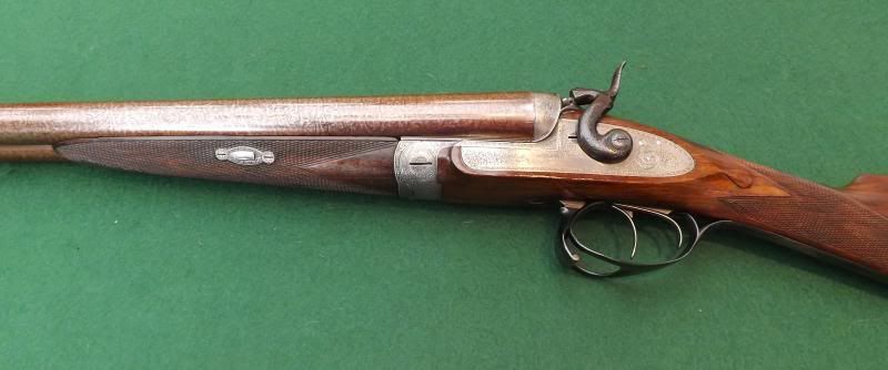

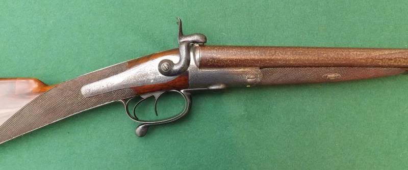

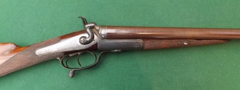

I think the one important point should be noted about British Victorian/Edwardian hammer guns is the locks in a lot of cases where not manufactured by the maker whose name appears on the gun.
The hammer guns in the pictures are from my collection and span from a first line London maker Purdey thumb opener, Robert Adams with a Jones under leaver opening a sound London maker though quite a way from the top line of makers to C.W. Ebrall a good quality provincial maker with locks having a half cock/safe position with under leaver opening.
Now they all have one thing in common the locks on each of the guns are made by “Brazier” one of thee top trade manufactures from Wolverhampton in fact the Adams action was manufactured by Brazier and possibly they completed the gun.
The Ebrall pin fire hammers have always looked rather to large for the gun but there may be a reason but it escapes me. Also the barrels which are Damascus have the remnants of a browning method known as “Russet Browning” that was popular with wildfowlers on the west coast of England the surface rusted finish is rather thick and obliterates the light dark pattern, the rust was then treated with a mixture of Tallow and Goose fat.
Purdey
Adams
Ebrall
