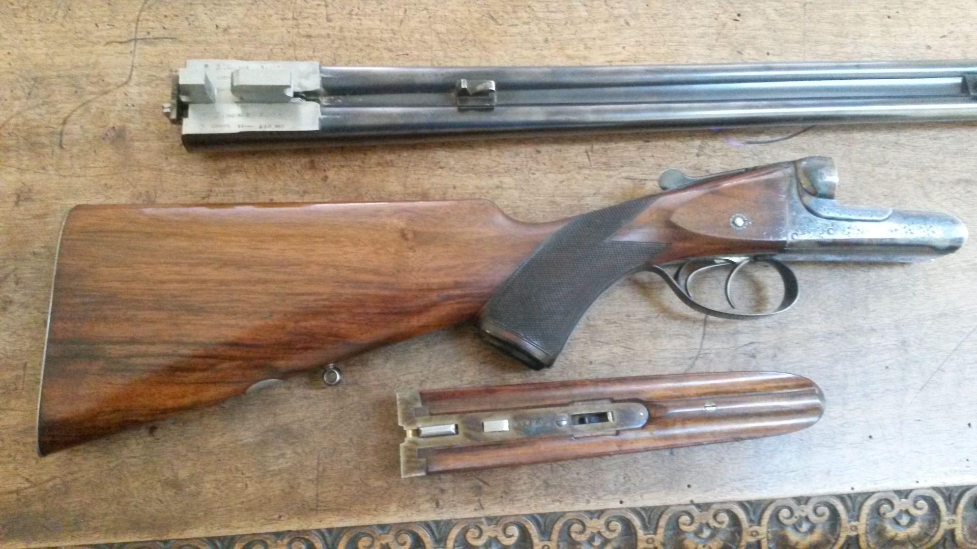

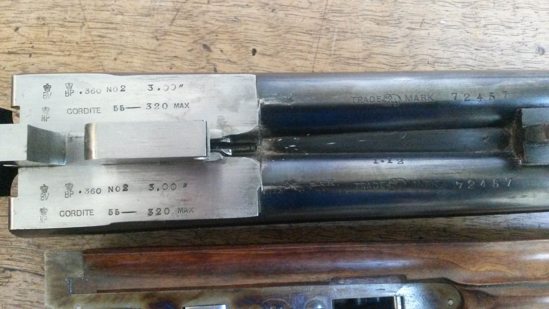

Hello Folks,
I just received a Greener Empire double rifle dated 1928.
It's hard to see on my poor picture but there is "ZSR" stamped on the tube.
The Graham Greener letter mentions that the rifle was made with "ZSR" steel.
Does anyone has any idea what that is?
I googled a lot but got nothing.
Best regards,
WC-
P.S> Graham thought this gun might be one of a kind, but I know there is at least another one around.

Please post photos of action and action face of your Empire double rifle. It is a rare gem. I was not certain that any had ever been made. Is the action the same size and with hinge pin the same size as the Empire shotgun?

Great cartridge and usually the rifles are under valued on the current market. How about some pictures of the rest of the rifle? I love Greener rifles.

I added another poor picture of the gun.
The gun has a long bar, Baker ejectors and bushed strikers (and of course, Greener bolt and safety) .
I really like the Empire action as it is amazingly simple. Better than any other boxlock system I think. Using the main spring as a pushrod and ejector trip was a brilliant idea.
