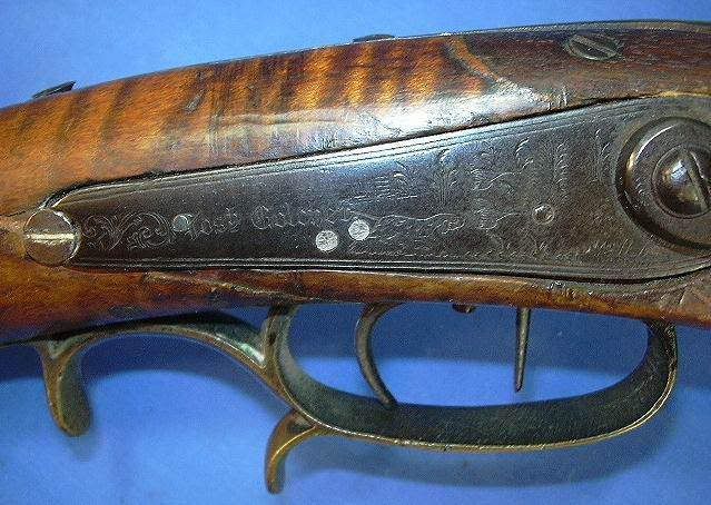

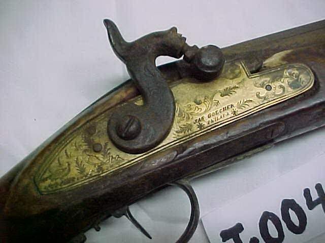

With American muzzleloaders. If the gun was assembled from parts, then the lock maker's name is usually on the lock. Else if the gun is done entirely in house then the maker's name appears.
In this case Joseph Golcher of England never made any guns, but was a lock maker. His locks appear on many American muzzle loaders. People confuse him for his brother James who came to Philadelphia and also produced locks in his career. They incorrectly insist that "Josh" was an American gun maker.
To add to the confusion. It is not uncommon to see a flintlock that has been converted to percussion. This could have been done by the original maker or a 3rd party. Early 19th gunsmiths often advertised "white smithing". It was their way of saying they had the locks to do the conversions.
