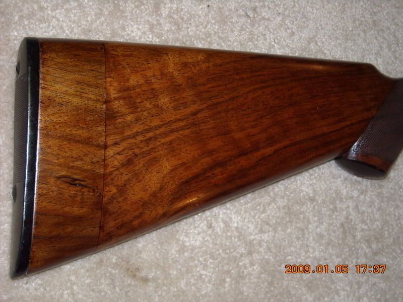

There are some people that can do wood extensions and I applaud them. I bought this Specialty Grade 12 ga., everything about it was great, nice crisp engraving, Hunter One-Trigger, ejectors, nice barrels, but the lop was 12 3/4" to the end of wood. Someone cut it and added a Pachmyer De-excelorator pad that was 1 1/2" long and just that alone weighed close to half a pound.
I added a piece of walnut that was not grain orientated and tried to blend the colors and fauxed some grain. I like it better than the recoil pad, and there are only two screws holding it on if I get some better grained walnut in the future.

Doug that is stunning work. Also, by having a specular highlight (glare) on the stock, it really allows you to appreciate how seamless the joined extension is.

If a little more time and forethought had been taken with your wood extension you can now see how much better it could have been.
If that extension had been fitted 180 degrees the grain would have been a much better match.A little colour and a bit more care blending and it would have been, how do you guys say 'durn perty'

salopian,
Unfortunately the length of the extension wood was very close to the finished stock and the grain orientation wasn't long enough in the toe to do this and that is why it is "upside down".
When you have grain that is running like this one, you almost have to put the other piece on a 45 degree angle to match the stock grain.
I'll live with this for awhile, I just didn't like the looks of that recoil pad. I'm not fond of recoil pads to begin with.
The leather is a nice idea, but then you have to form the extension smaller to allow the leather to be flush with the stock. And I agree the toe would be hard to do. The leather would almost have to be wet (damp) to let it shrink to fit tight.
