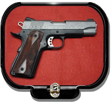

A friend of mine sent me this link, though some of you Damascus fans would find this somewhat interesting..I think its pretty cool http://www.damasteel.com/firearms.html
What are you thoughts? Anyone here ever seen anything done by this company?
Dustin
Dustin,
Very aware of damasteel. The metal is not damascus in the traditional sense. They are a Swedish corporation that started in 1995. They use a process involving rapid solidification metallurgy, which they did not invent. It was invented at Northeastern University in Boston in the early 1980's.
There have been forays into firearms using this product, most notably was Caspian who produced damasteel slides for semi-automatic pistols. Zbrojovka Brno had some barrels made up in addition to traditionally produced damascus, they went out of business before either was ever produced in quantity.
It is possible to produce some very colorful products using damasteel. Again this does not even come close to the traditional methods as damasteel uses extreme cold to produce colors.

Ya Pete, I remember those Caspian slides from back in the day. I did not know that there was anyone making barrel blanks out of the stuff though. I would like to see a doublegun with these tubes. I think it would be pretty cool. I'm with you, this process is no where near what the traditional methods were to make the tubes...but neither is CNC, wire EDM, Spark Eroders, etc. that are being used to build todays best guns. Do you know of any shotguns, custom or commercial that have been built with these tubes?

To my knowledge, no one has used damasteel to produce shotgun barrels of any type. Oscar Gaddy and I had many discussions on this topic. We eventually decided to take on the project. Oscar had a M21 that had been through a fire. He was going to retemper the action. It was left to me to find the barrels. After many attempts, we had to give it up. I could not find a supplier for the blank tubes. The American supplier was unable to acquire stock of the correct dimensions. I even called Sweden and spoke to some one at Damasteel about this. They were not interested in a "one of" type of project at the time.
