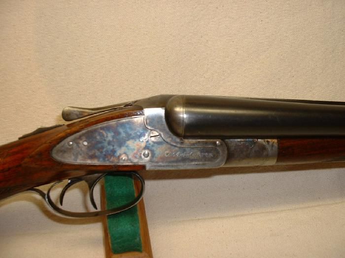

This is the entry level Model 18.

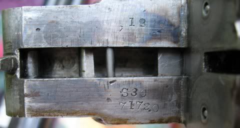

Sometimes on the rib you may see Crystal or Armory or even Krupp. For the most part, if you remove the barrels and look at the watertable they are marked with the model, barrel type and length and serial number. The barrel type can be T=Twist, D=Damascus, S=Steel, K=Krupp, C=Chain Damascus. This coding is not found on some of the very early guns. On some of the very late guns it becomes a bit of a hit and miss.
Model 18 with 30" Steel barrels. Made about 1915.

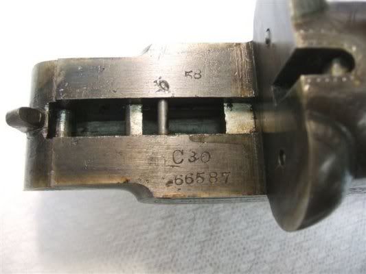

Model 58 (top of the line catalog gun) with Chain damascus 30". Made about 1914.

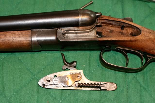

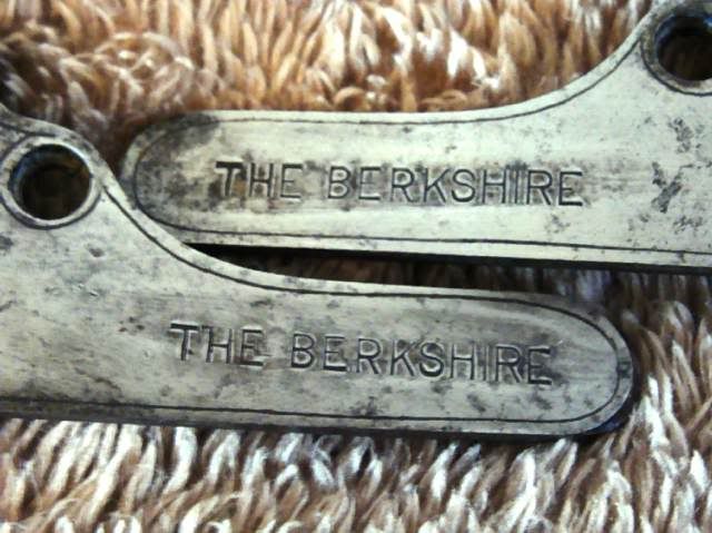

Here is a set of Berkshire locks.

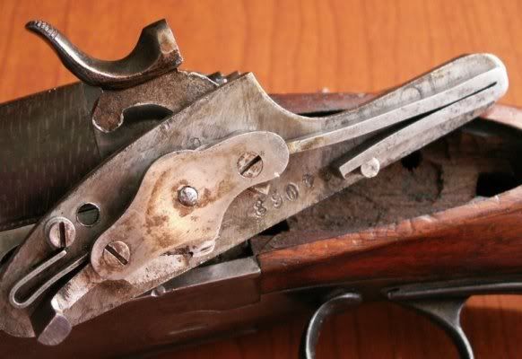

These are Aubrey Hammer gun locks.
They seemed to be producing hammer guns based on 2 different forgings. Both were around from the beginning. Not enough hammer guns have surfaced yet to draw any real conclusions.
