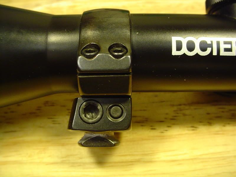

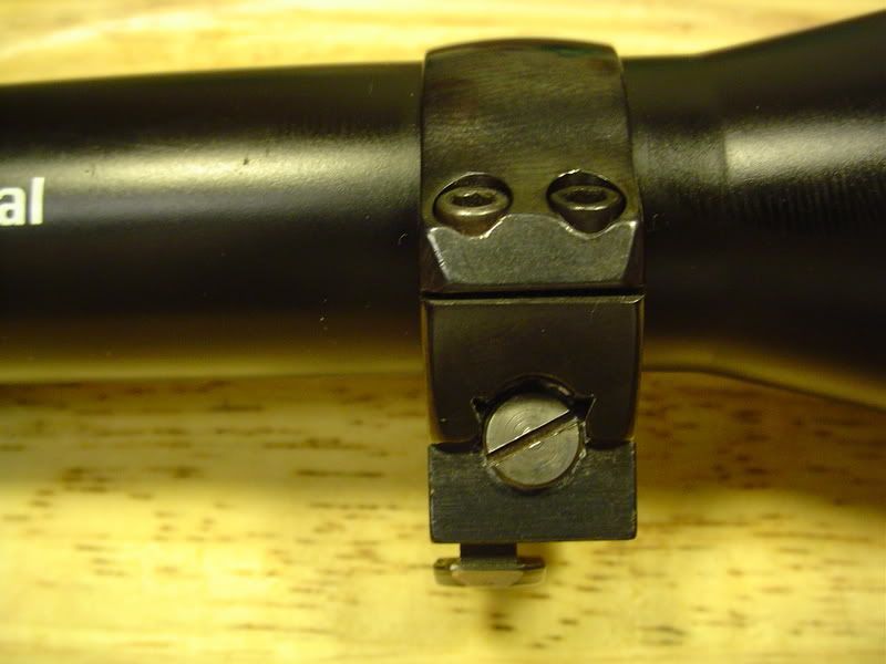

I bought this 8x Aspherical Docter Optics Scope from a local pawn shop.Supposedly it was brought back from Europe by a GI.The tube diameter is 26mm. I have not been able to identify the scope rings manufacture and thought someone might recognize them. The front ring has a conventional dovetail type mount but is not of standard US size. The rear ring utilizes a small dovetail type mount and is adjustable for windage.

Have you tried the German Gun Collectors' Association website? They probably have an expert in Euro scope mounts.

Looks like a set of EAW swing mounts...

I too vote for EAW pivot mounts. Try Dieter Appel's place in New England-I think NH. NECGS??? Got parts for one there 7-8 years ago. 26mm = 1 inch roughly. Good Luck, Dr. Bill

It does not appear to be EAW, or ERA-Recknagel mount. It's DDR-made 'Swenkmongage'. Now, the bad news. The rings and mounts are ALWAYS sold as a unit, so there is no matching, luving, mating,....
