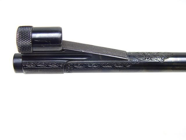

Why do sporting rifles have front sight hoods? I’m interested in learning what your take on them is.

1) Sight protection, especially while riding in, or being placed in or removed from a saddle scabbard.
2) Consistent light condition on sight.
3) Some permit the use of different sight styles and shapes.

IMO they are for protection alone, and the US styles are intended to be removed before using the iron sights. I also draw your attention to various UK-made bolt rifles with folding hoods, IMO they are intended to be folded before using the sights. I can think of no instances of sporting rifles with non-removable or non-folding hoods, and this leads me to believe that the makers intended them to be easily removed or folded. This follows my own thinking, I want as much light on the front sight as possible and that means no hood. Plus, the need for a special safe temporary storage place for the hood is an excellent justification for having a trap door buttplate(G)!

I like the hoods to avoid sun glare. That does affect my point of aim substantially. Some sights, like Lyman 17s do not remove and are intended to be used that way. The one above may be similar, though it is hard to tell. I would not want to be shooting more than 100 yds with irons if the front sight is uncovered, hence, I put one on my "bean field" percussion muzzleloader and on all of by bpcr hunting rifles.
