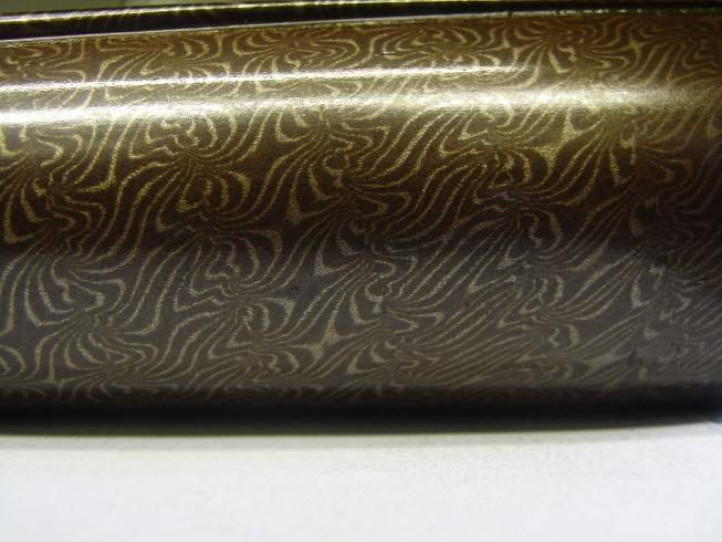

Drew anyone whats this pattern? taken fron a 12/b by F.E Webb of oxford.

Thats a new one on me. It's nice though.

ribbons and bows??........

Very nice Paul, and glad you're back in the shop. How's the knee?
When you find the 'British Damascus Rosetta Stone' we'll know what y'all called it but we Colonials and the Belgians called it Two Iron "Horse-shoe" or Damas Crolle' Plunger-Lemoine. Remington called it "Boston N."

This is interesting, and demonstrates how the twisting technique alters the pattern (with the same 'lopin'.) It's a c. 1875-1887 J. Crockart & Son "The Acme" courtesy of Heritage Guns, and the right barrel 3 Iron 'Turkish' becomes 'Horse-shoe.'

'End-on' rods seen at the breech - looks like the rod started with 4 iron and 4 steel strips

Hi Drew I thought you would know, the leg is ropey going in hospital to have a camera in the knee on tuesday, that last pattern you posted I have never seen one like that before.
