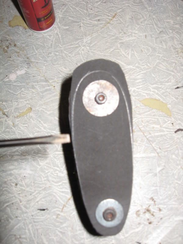

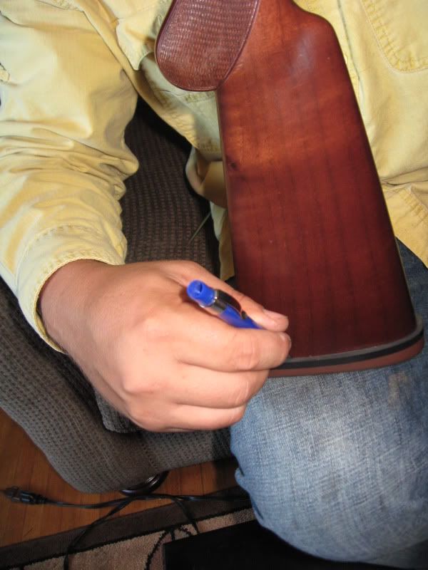

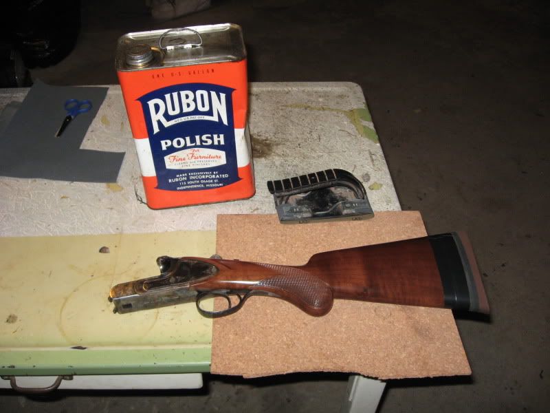

1. First I attach the pad to the base of the gun and trace the outline of the stock onto the pad

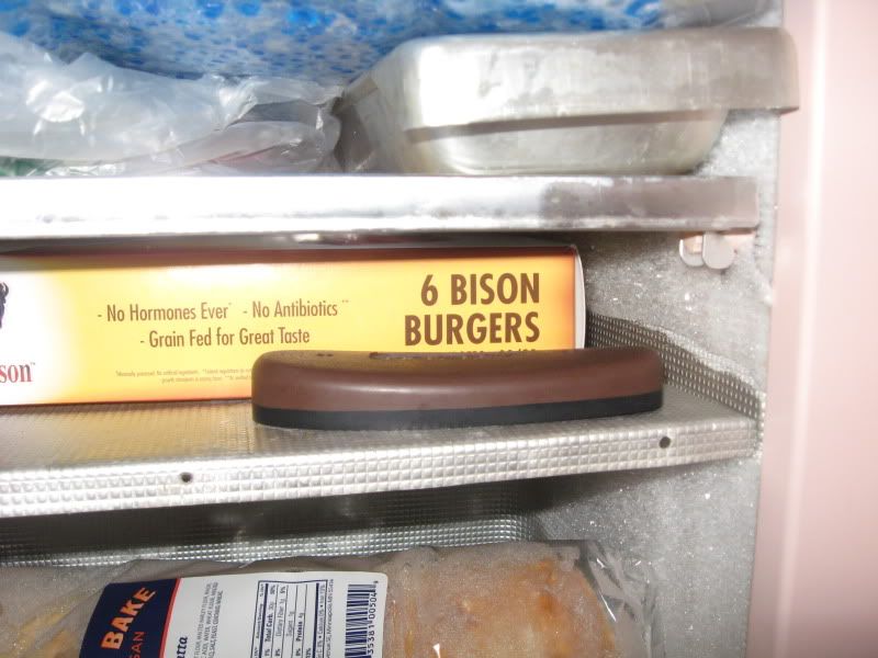

2. Next I put the the pad in the freezer over night to harden the rubber to make the pad grind easier. The toe often is difficult to grind even due to the softness of the rubber. That is where freezing the pad comes in handy.

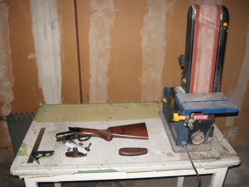

3. The tools used: I use an upright belt sander with 180 grit paper. I also use a pad grinding jig (Miles Gilbert, cost $50.00), square, screwdriver, furniture oil, and a sanding block.

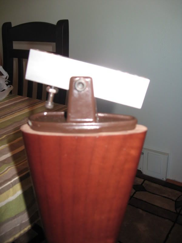

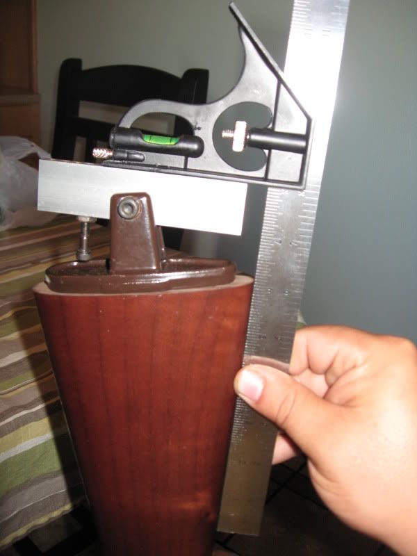

4. I first set up the angle of the heel for grinding by putting the jig on the stock.
The bolt under the aluminum bar screws out until it bottoms out on the bottom of the jig. That is where you tighten it down for the correct heel pitch.

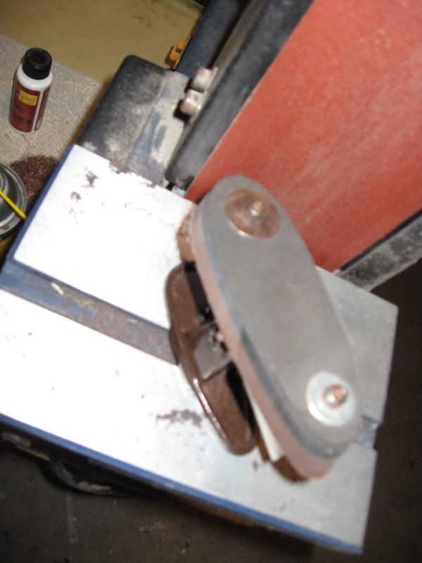

5. I next set the pitch for the toe to be ground. The center bolt that holds the aluminum bar is tightened to hold the angle.

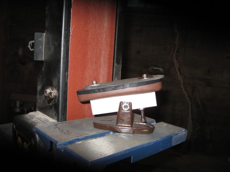

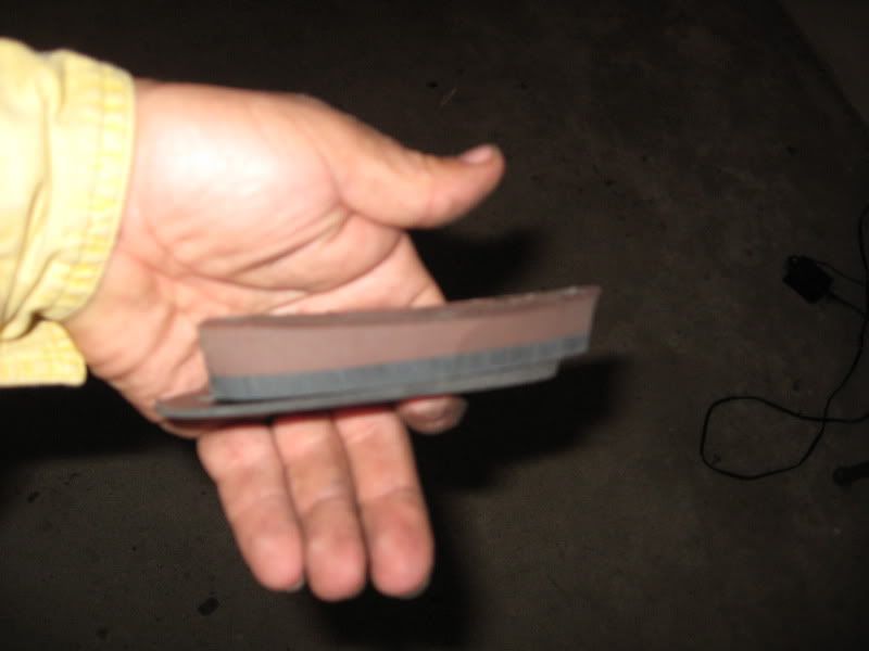

6. I now bolt the pad to the jig and begin to grind the toe of the pad.
I grind to about the mid point of the pad to ensure the sides stay even for the final fitting.

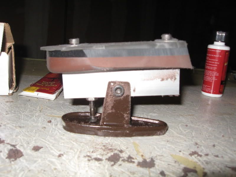

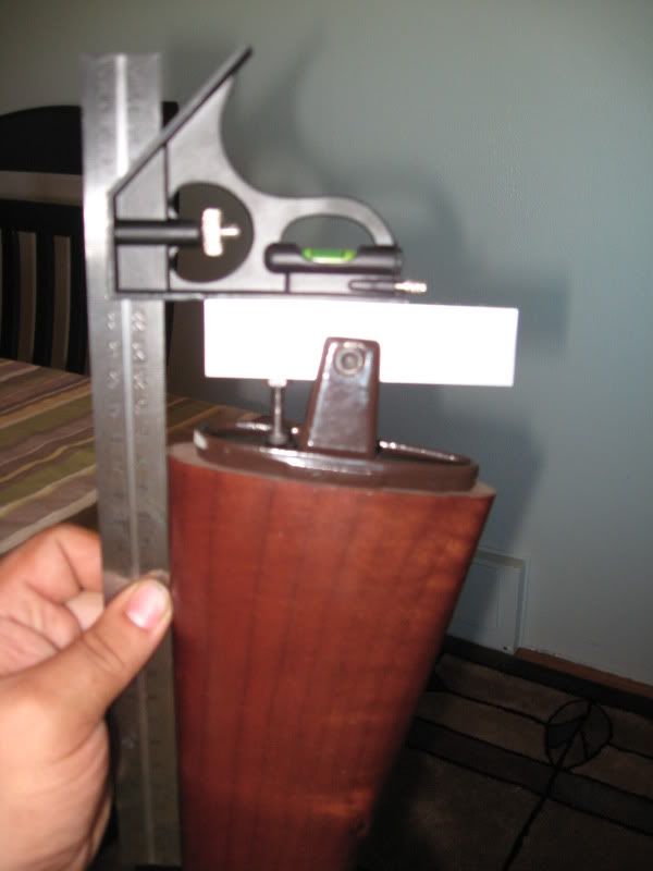

7. Next I loosen the center bolt and tip the pad down until the bolt bottoms out on the jig like in step 4.
I tighten the center bolt again to hold the angle and then I grind the heel.

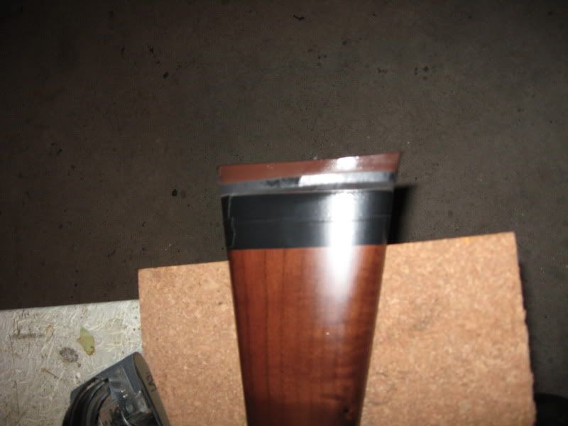

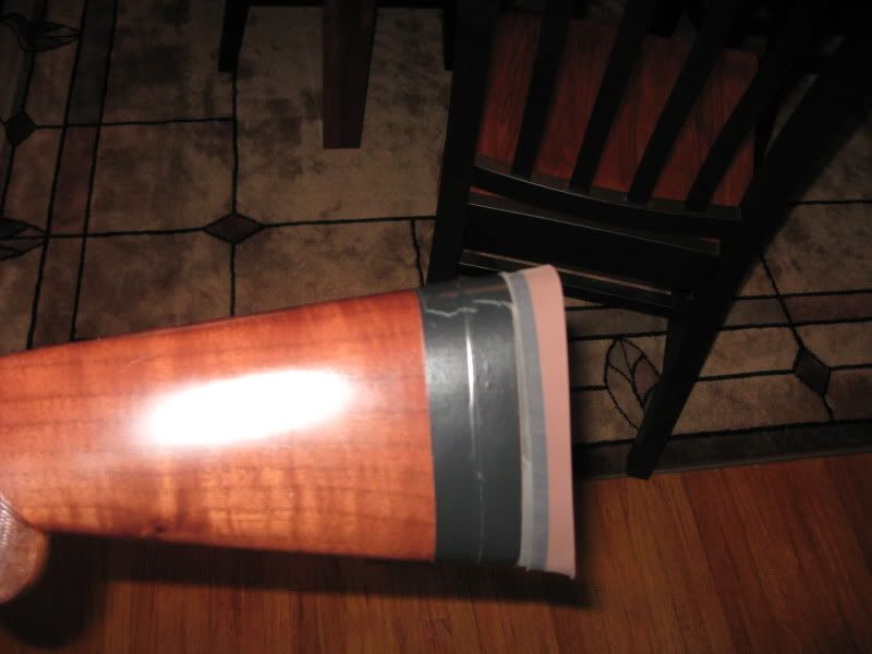

8. I next take the pad and the spacer off of the jig.
Then I reattach it to the stock which has had black electrical tape carefully wrapped around the stock to protect the finish during pad installation.

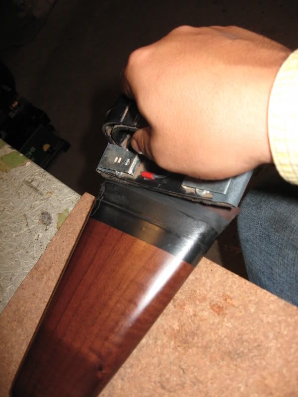

9. Here is the pad installed with the sanding block and oil I use.
I wet the pad down with the furniture oil prior to sanding.
I then begin to sand using wet/dry sand paper in 180 grit. I wet the pad down often while sanding. I finish the pad off with 220 grit.

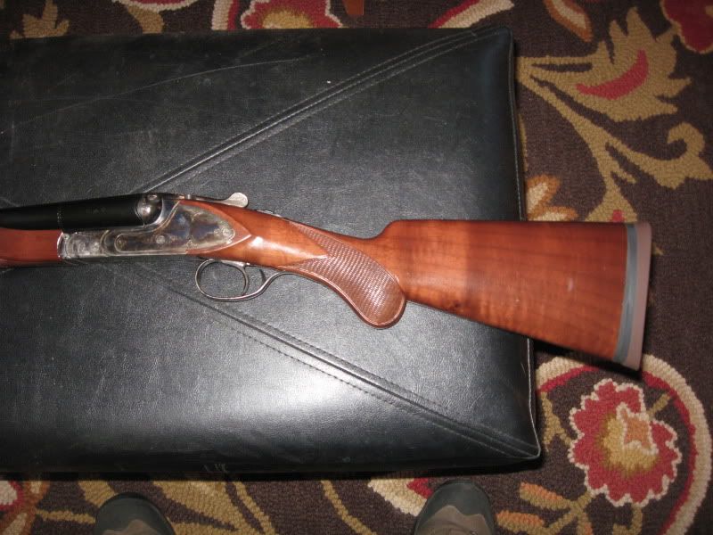

10.The finished product.
I highly recommend the jig. I have ground pads for myself and friends so it has paid for itself many times over. The time spent on the project was around 2-2 1/2hrs in total. I hope you enjoyed the pictorial and it will inspire some of you to try on your own.

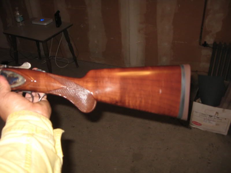

The only one I have done was using a method like Gordon's , i.e. disc sander, no jig.
I think it turned out rather well:

Thanks Jani, when I got it it looked like this:
