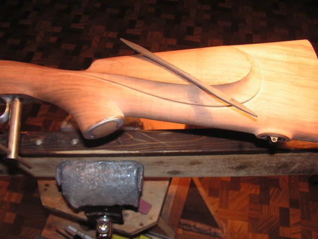

Not sure what beading is, but for working in shadow lines, we have had good luck with auger bit files - two safe edges on them. And enough of a curve to them for working inside radius.

That is how I do them as well. Not very hard, just be patient and take your time.

Because by the time you do the finish work, the last thing you want to risk is driving a chisel too deep. Much easier to control depth using a rasp and file. In reality you are not removing much material to create a shadow line. If you are working towards keeping a stock a certain dimension, I will opt for the slower safer method anytime.
