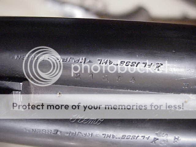

Some interesting marks on what looks to be a pre-1912 double by Remo that Mr. Hallquist brought to my attention:
I think the "WK" stamp just might be the predecessor to the heart shaped "W" which envelopes the "K" of Wilhelm Kelber.
