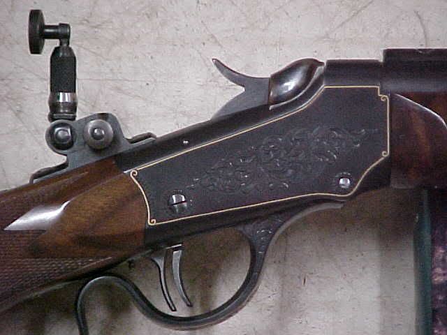

Not in Steve's class but IS in my safe! IMO a high wall is a PITA with the 22LR and a Ballard is entirely too heavy and clunky for a RF sporter, JMO.
I'm currently in-process building another low wall similar to this one but in K-Hornet. And, whenever funds and tuits become available, I'm planning another 256 Win Mag low wall. The 256 is quite a bit more powerful and more versatile than most other small-game cartridges of similar capacity and the low wall action makes up into a splendid little rook-type rifle. This one is just hangin' around the project wall in my shop, awaiting tuits and funds.
I like low walls, in fact I like many of the older single shot actions but each for slightly different reasons and purposes.
