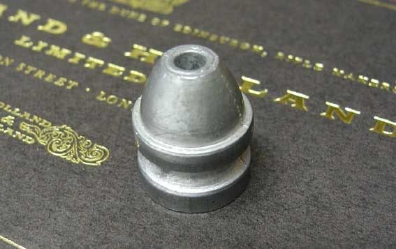

The projectile best suited to the Colindian is almost certainly the 'Fosbery'-style projectile, which is slightly cotton-reel shaped, and typically weighs 750gr as a solid, or perhaps 690gr if hollow-nosed. The nitro versions of the cartridge would have been loaded with chopped cordite, moddite, axite etc, which are unavailable commercially in the west today. Best modern loads are published in the second edition of Graeme Wright's "Shooting the British Double Rifle", Chapter 14: Paradox Guns. I strongly recommend you purchase a copy.

Almost forgot: Photos of Fosbery-style projectiles from my mold.
Several custom mold-makers in Australia and US carry this pattern. This one is from CBE (Cast Bullet Engineering).

I have a hammer Colindian and made a mold for it very similar to a solid nose version of what Marrakai showed. In my case the bore is .018" out of round so I made the bullet the average diameter or .009" over minimum diameter and of course .009" under maximum. I have only shot the gun a little and am undecided as to whether I should have made the slug larger or not.
