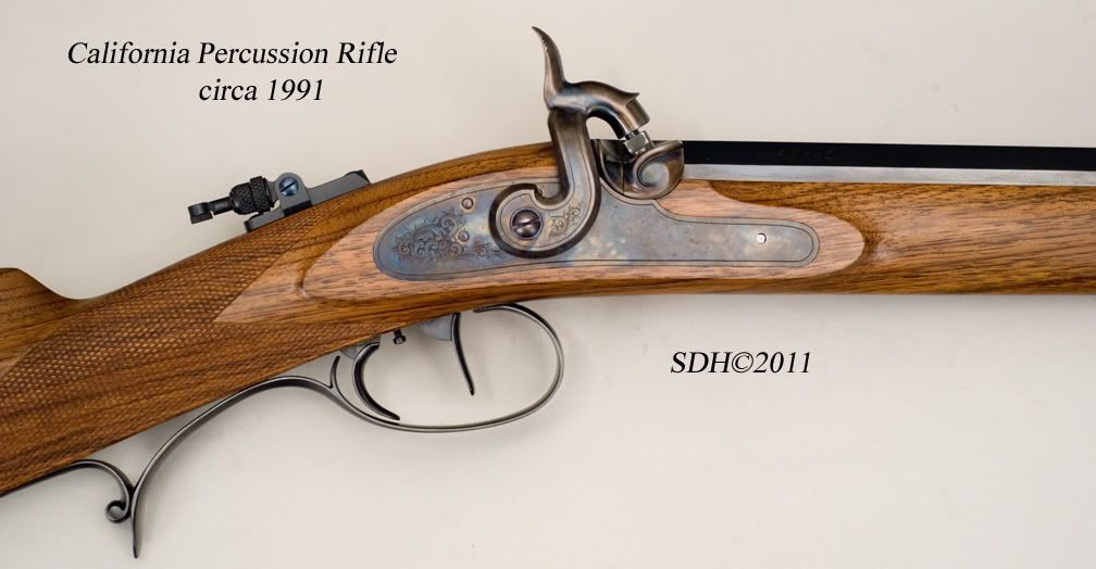

Here's a very different, similar idea I did in a previous lifetime...
Reshaped Griffin Hawken lock and breech. Custom tang sight base with Marbles (off-set for cast-off) stem.
A .45 cal. bullet rifle I've shot a couple of deer with.
