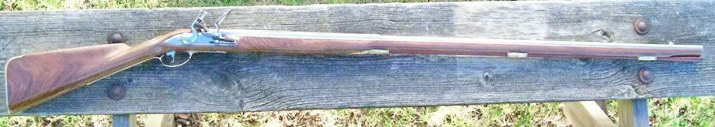

Trying not to make a mistake and have to redo it. I have this 20ga fowler that I built and it is shooting low. There is no rear sight, but the PC/HC notch that is filed in line with the tang screw, screw slot. The front sight is also the traditional short front sight so there is no material left to remove. So, I need to bend the barrel to raise the point of impact. Here is my dumb question. To raise this "point of impact", which way do you bend the barrel, up or down?

Thanks all. The barrel is straight at this time. It is a Colerain's 44", oct. to rd. 20ga. barrel. The front sight is considerably lower than is shown in this picture. Maybe only a 3rd of what you see here. My plan is to then bend it forward of the wedding band. [img:center][/img]

Am I missing something here? If you want the gun to shoot higher, lower the front sight. Since you have very little left to remove, you need to lower the muzzle end of the barrel. I would work with the wood. Slope the channel the barrel sits in downwards toward the muzzle, or bend the stock up a bit. Nice looking gun but apparently not stocked properly, at least for you.
