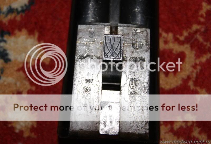

Drew if theose stamps are Cavemen just forward of the flats on that Tobin, I'd really like a closer look.

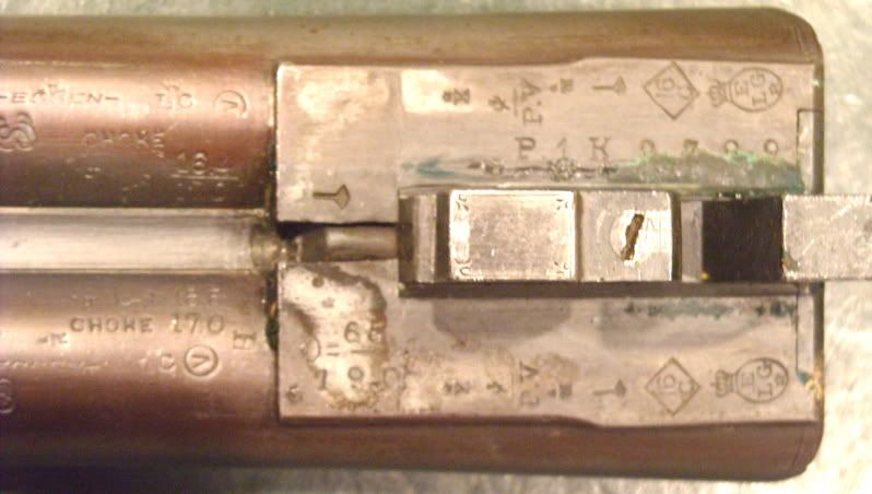

This stamping effort in 1947 looks as if someone wanted you to think that Sauer made steel with the "S"s in the rings and J.P. Sauer & Sohn in the band where Krupp Fluss Stahl is usually seen. I've seen those stamps on the lugs on Merkels and I'm curious if they are related to pattern counts?
