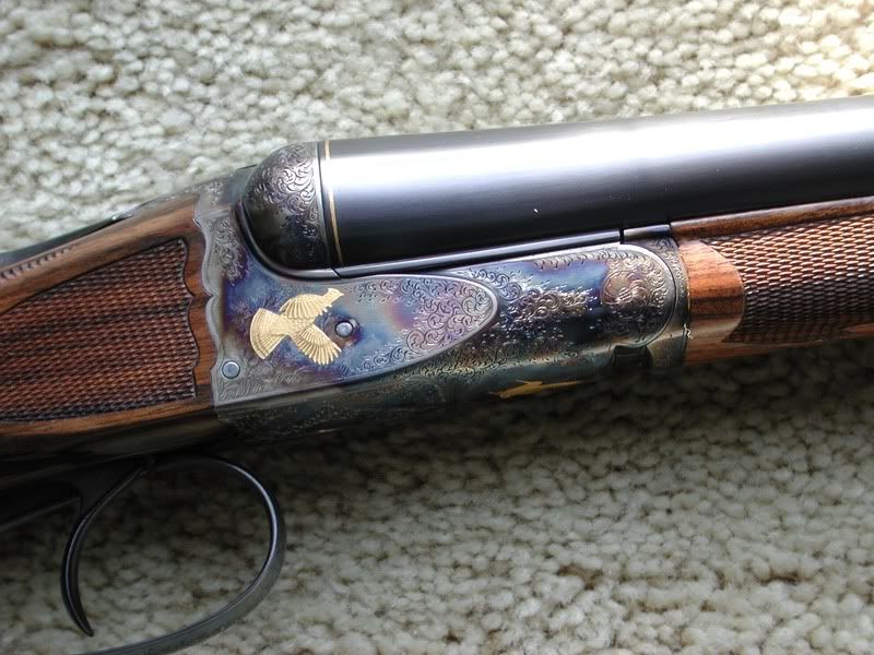

These would be non-original case colors provided by Oscar Gaddy.

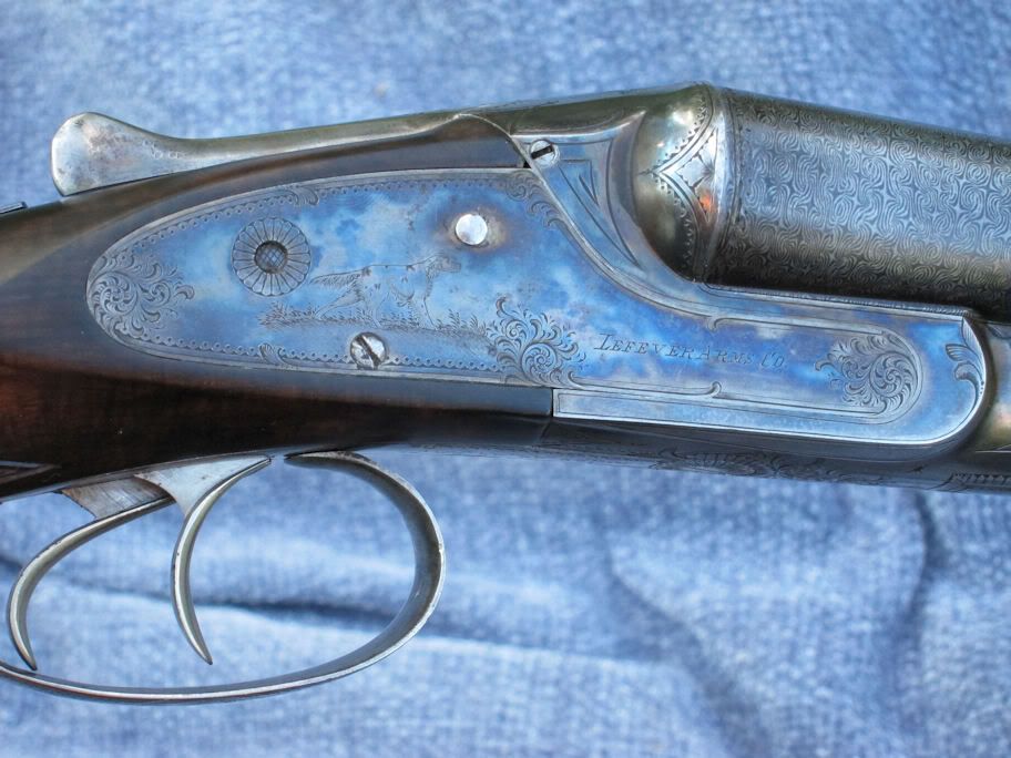

Lefever E grade 35,XXX serial number range. Not 100% but does has nice surviving case colors.
