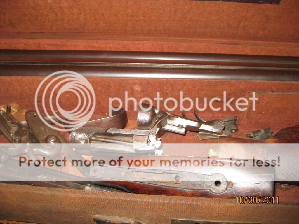

It is a Patstone Bar-in-wood 12 hammer, EJECTOR. Busted all to heck at the wrist. The stock was 3/4" cast on until UPS made it into 2 pieces.
I got as far as making a piece for the wrist that replaces the busted piece and get the stock to 1/4" cast off.
I got distracted and tossed it all into the case years ago. I am thinking winter is the time to get this old gal back into 1 piece.
The ejectors were added at a later date. The action was converted to back-action to make room for the ejector mechanism. There is a lot of engineering to get all of that stuff packed in.
The rod running through the action body is the ejector acting rod. They both are drilled through the hinge pin.
The current state is what the Brits call "reduced to bits".

Joe, was the gun shipped assembled? I once bought a gun that was shipped assembled by the seller and the same thing happened. The deal went south and I got my money back. According to the gunshop owner where the gun had been sent, mine wasn't the first he'd seen to be damaged similarly. If assembled, the handlers can get more leverage on the stock to damage the gun. My shop buddy said in his instance it took over a year to get the claim paid by USPS. It took a lot of leverage to break the stock and bend the stock bolt of his 870.

I bought it broken after the owner had recieved payment for the loss. The gun price was, very discounted.
I wanted it because I had never seen a bar-in-wood ejector before.

Let's have some close up photos of the knuckle on that action. Then we can see how haggard you're going to be.
