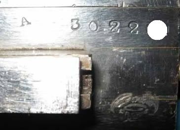

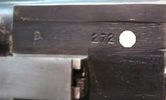

If the seller provided the serial #, they should be able to provide the grade. Typically, the grade will be stamped on the action flats near the serial number...
