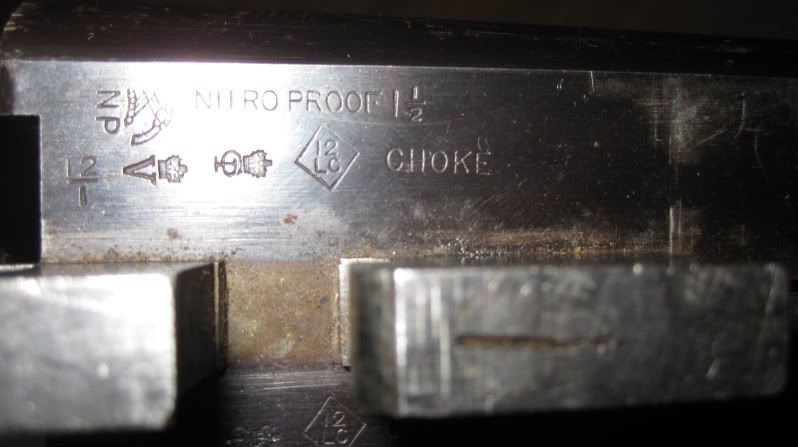

Gents,
How do you interpret these? Suggests to me gun is newer than serial # suggests.
Marks are on a very plain C&H BLE sn 40714
Thanks
Mark

Mark--I date your gun from the period 1904-25. The NP with the sword was first used in 1904, and the 12 over LC was last used in 1925. (That latter mark should indicate that your gun has 3" chambers, which would also fit with the 1 1/2 oz shot charge.) After 1925, the chamber length would have been marked on the flats.

Larry thank-you, my memory had the 1925 change reversed, 1904 falls into the sn/date perfectly.

Steady with it though. It does have 3 inch chambers but was proofed for the old type English 3 inch magnum cartridge. You will find that the European 2 3/4" magnum rounds will be o.k. assuming the gun is still in proof. Lagopus.....
