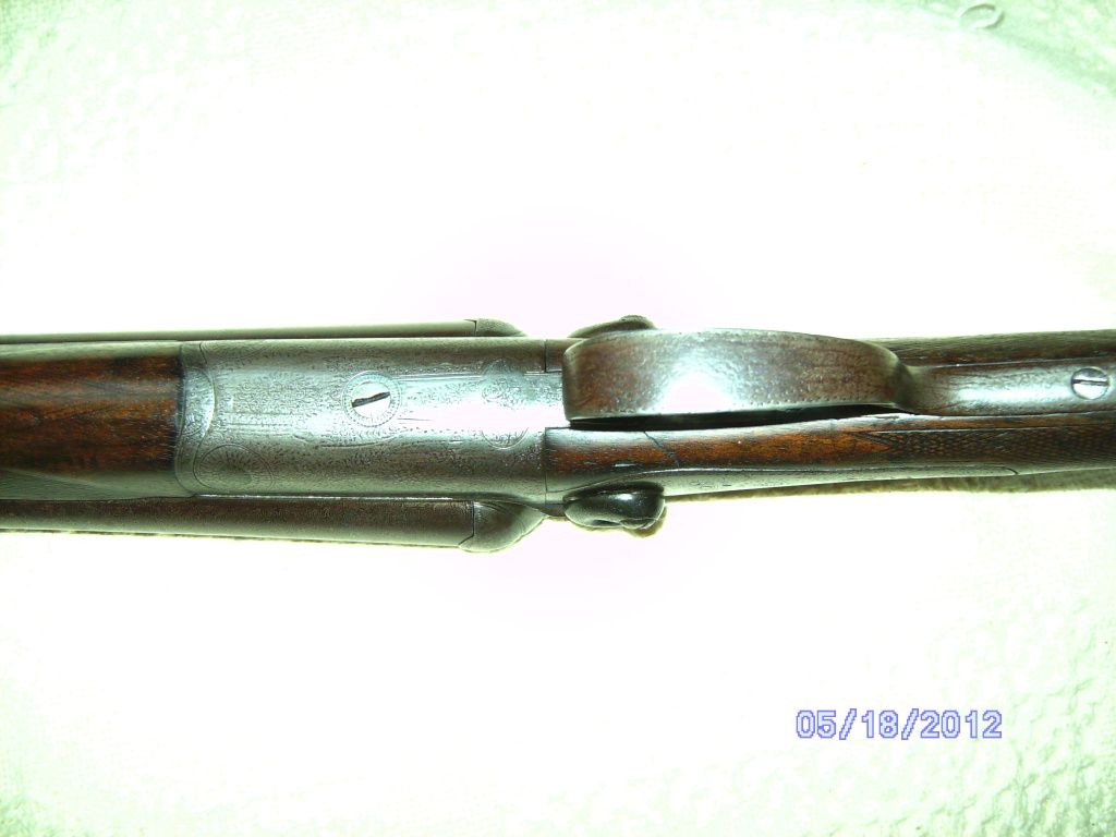

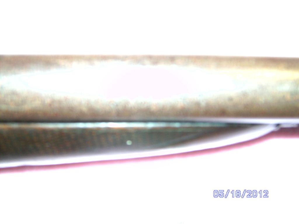

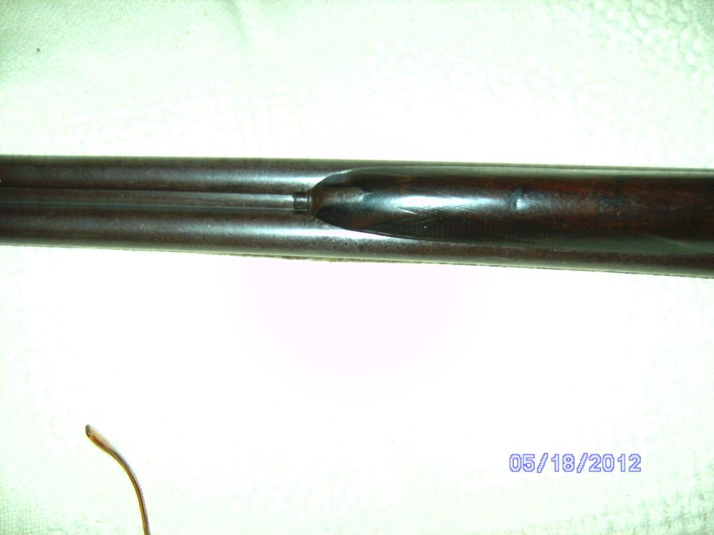

Here are a few pics. I hope thy can help.
The proof marks may not show this well in the light I had.

Pretty worn but a nice looking gun nonetheless, of course I have a weakness for hammer guns with back-action locks and English grips. It'd be great if you could take some better photos, I've found setting the shot up using a tripod or similar and putting your camera on a timer (so you're not holding it when you take the photo) will help quite a bit to get clearer photos. However, I'd guess that Gunman is correct.

The barrels might have been from Francotte, or might have been a Francotte Damascus pattern. But that does not mean the gun is a Francotte. The Francotte proprietary mark will be found amongst all the other proofmarks on a Francotte-made gun: AF under a crown. Lacking that, it's not a Francotte. Can't tell from your photos, but since you didn't mention it, I'd guess it's not there.

Don't look Belgian to me .

The pics are lousy but thanks for not describing them tthat way. smile I would need to get a better camera and better lighting should the need for them arise.
I strongly suspect that Gunman is correct. There is no marking of Francotte anywhere and only one small F and the numbers 211 in separate locations on the rib underside. There is one marking I didn't describe. It is Crown over a P where the P curve flows to an almost oval ending under the Crown.
Edited to add that I found this P mark in a lsiting of English proof marks. http://proofmarks.tripod.com/englishproofs.html The 13th and 14th down in the London column apprear on my gun. Note that the notation Not English Made does not appear anywhere on the weapon.
There is only one marking (the Diamond with 12 inside) from this listiong of Belgium proof marks but the same mark is also shown in the English proof marks.
