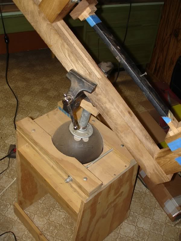

IMHO, the most important item that you can have is a checkering cradle to hold your work in. I've made my own for probably less than $10. I know a lot of people say that they use sand bags etc to hold their work - well God bless'em. I'm going to post a picture of some checkering with fleurs and ribbons in it that, IMHO, needed both of my hands free to work and have a really solid base to hold the stock.

Not that I intend to do my own checkering but I would like to see the device you use to hold the guns when you do your work. Best, Jake

Jakearoo #24779 02/08/07 10:20 PM
Posts: 753
Likes: 23
Posts: 753
Likes: 23
Jake, this is a really poor photo of the cradle but its the best I have tonight.
