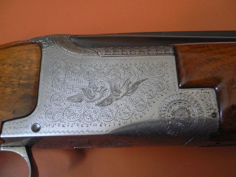

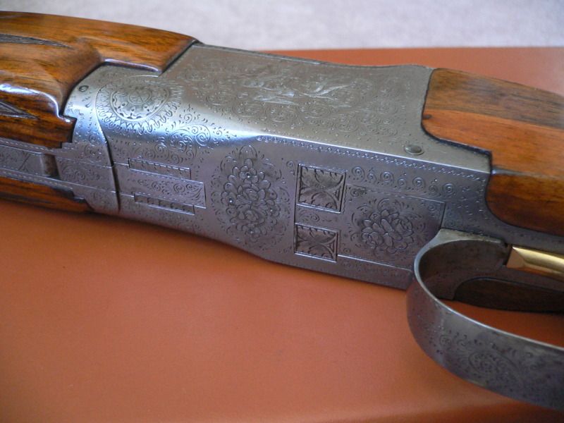

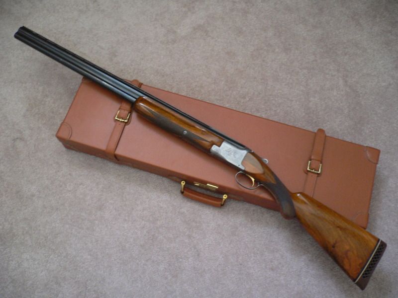

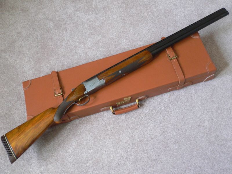

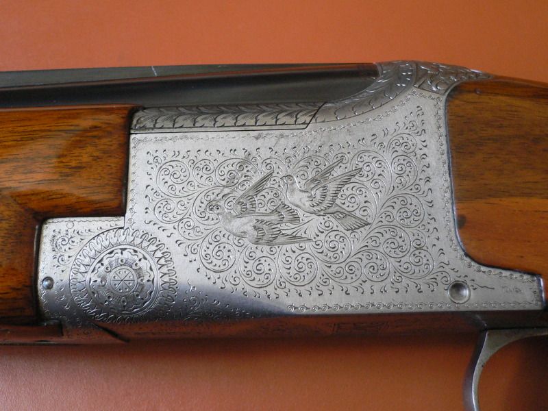

I am new to Browning O/U shotguns and I am looking for some info a gun that looks like a superposed action.
The barrel is marked Fabrique Nationale D'Armes De Guerre Herstal Belgique and Made in Belgium on the other side of barrel. The action is coin finished engraved with 2 pigeons on each side with scroll and flowers. The fences are deeply engraved with some leaves. The recoil pad says Browning white line but it is possible that some one has changed it. Is this an FN or a Browning gun. I am assuming that it should say browning either on the action or barrels if it is made by Browning.

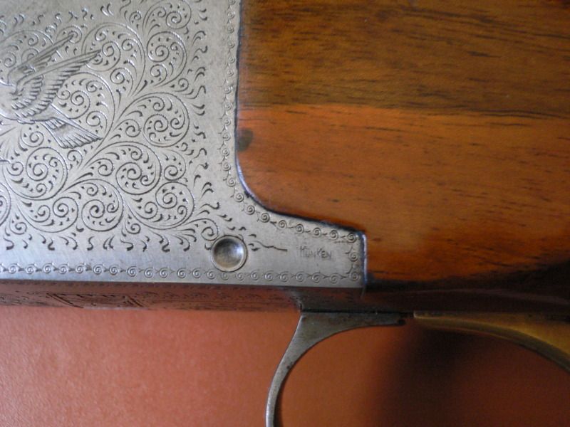

Although it says Funken in very small letter on corner of the action, hard to see unless you look closely.
Any info with model & value will be appreciated.
Thanks

Pigeon grade engraving. Bobby
Funken signed Pigeon Grade Superposed, a wonderful old gun
SWEET!!!
Long tang, round knob gun??
What chokes? Any modifications? How long is length of pull?

Looks like a Trap model to me.
I can't discern if the forearm is a semi-bevertail or not, but the forearm checkering rising only to the mid-height of the forearm indicates to me a "Trap" forearm. See page 123 of Ned Schwing's Superposed book.
If the Drop At Heel (DAH) is around 1-7/8" then it's a Trap version.
From the apparent Length Of Pull (LOP), it looks like very little wood was removed from the stock when the pad was installed....only enough to remove the slight curve, to add pad to a straight line surface. So I would expect the LOP to be approaching 15" - just GREAT.
My $0.02 cents, anyway.

Serial #, gauge, chamber length, barrel length, chokes are all required to give any evaluation of what you have other than a Pigeon Grade, Funken engraved(one of the best engravers).
Trap and Magnum Grade will have a factory installed pad, Field Grades can have a factory installed pad but you will need to contact the Browning Historian with serial number for that info. Browning USA will only have info if the gun was imported into the USA by Browning USA, otherwise info will have to come from FN Belgium.
It's a very nice Super but need more info.
In any event Browning never made Supers, just FN made Supers, Browning imported the Super from FN. Since you don't have any Browning markings, it's probably safe to say that it was not imported by Browning.-Dick

Funken was one of Browning's master engravers.
