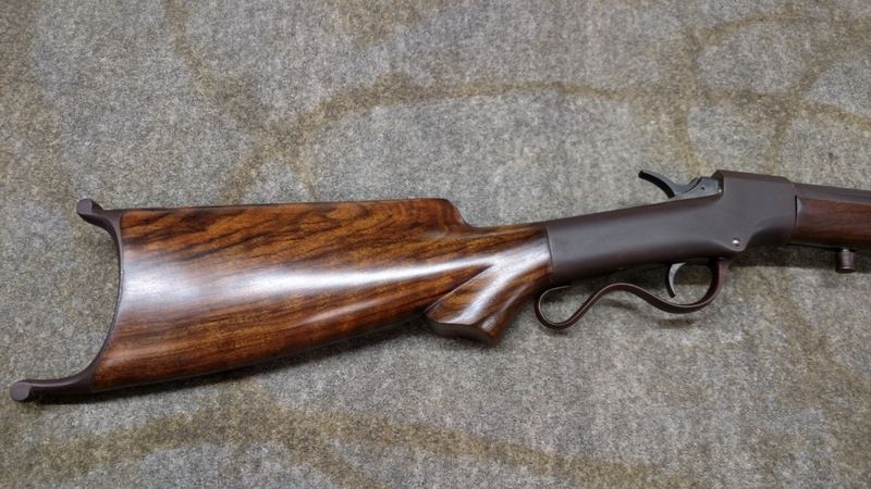

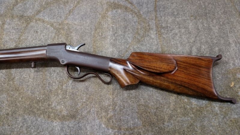

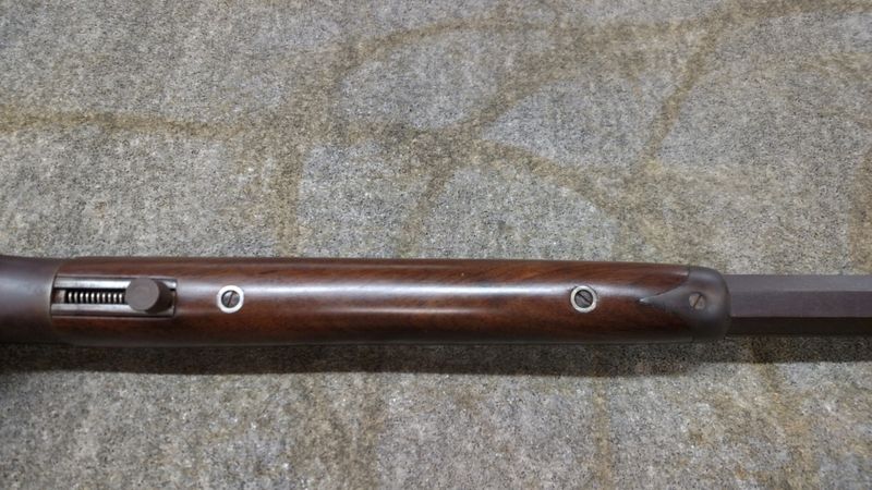

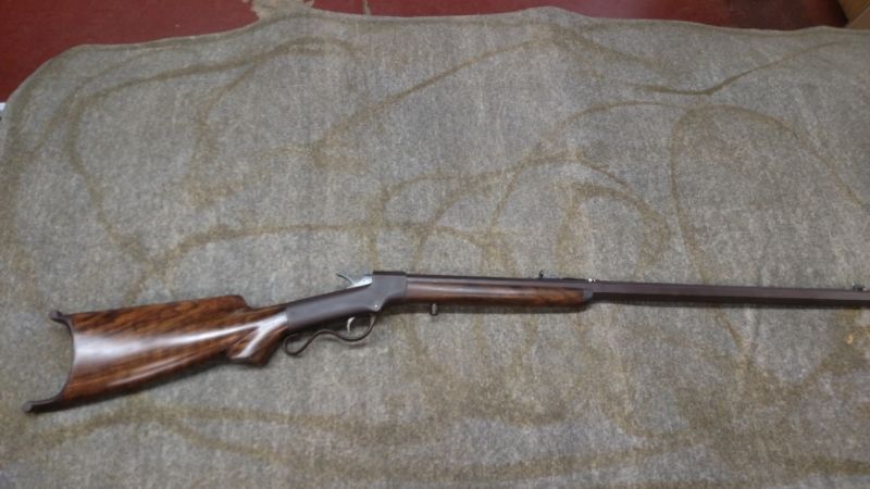

While perusing the forum the other day I noticed that I had not finished a thread that I had started about the conversion of my old Ballard to 17HMR. Well, I did finish the rifle a while back and I apologize for not following up. I ended up having to make a new forearm for it and just chucking the old one. I welded up all of the old dovetails and threaded holes in the barrel and refitted it with a new set of Marbles sights. After refinishing the original buttstock and browning the metal work I think it turned out pretty nice. It is a great shooter and is really more accurate than I expected. Wish J.D. was around to see the finished product.

Very nicely done clowdis! That's some beautiful wood, and you did a great job refinishing it! I don't own any pre-Marlin Ballards, and have always wanted to add one to my Ballard collection!

Thanks Vall! This one is about as old as they get. As you can see there was some consternation about rechambering in 17HMR but it seems to be doing fine. The wood turned out to be much nicer than I thought after I got the old finish off of it. I think I'll just keep this one and enjoy it.
