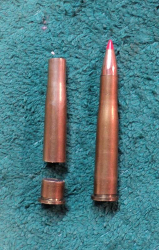

I also took the G&H .22-Lovell which has a Hensoldt with a post about the size of a 4x4.
First shot went way high and I ejected just the back of the case. Very old and well used G&H cases.
Got the front of the case out and got back to shooting.

I have a Niedner Hornet on a small rolling block action. When I got it years ago it had the front end of a Hornet case stuck in the chamber. No matter what load I tried the case broke in two just in front of the web leaving most of the case stuck in the chamber. Since Niedner was sporadic in marking calibers I just assumed it was a Hornet. Reaming to K hornet solved the case breaking issue. With the knowledge gained from this forum I now know it might have been an R2 maybe???????????????

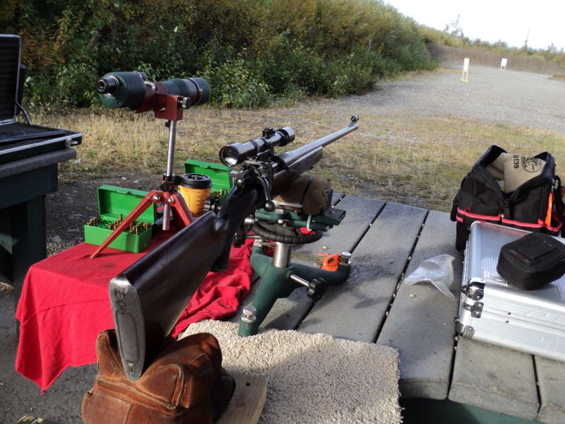

This rifle for lack of a better word is "Sensitive" Although in the last week or two I have used other names.
It likes to string them vertically and at first I thought it was the position of the forearm on the front rest. It does not do well off the barrel and the front sling swivel stops me from running the forend against the bag.
A cool 39 this morning but no wind and overcast.

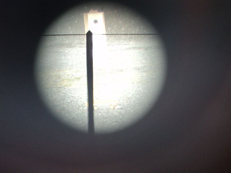

I could not see how good it was through the scope so I walked down and thought "Wow".
