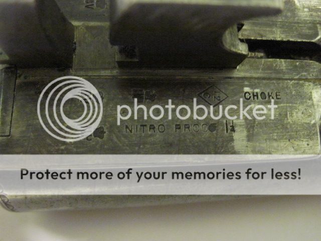

Thanks Drew. Here's the rib on my Hollis that looks like a couple on the site you posted. Maybe someone can tell us by the proof marks about when the gun was made.
Posts: 12,743
Posts: 12,743
Operating from memory here but I seem to recall that 1904 was the year the crown over BP replaced the crossed scepters on Birmingham proof. If that is correct then 1904 would be the earliest possible date.
Miller/TN
Posts: 2,768
Likes: 117
Posts: 2,768
Likes: 117
Yes, they are 1904 to 1925 marks. I would guess at the earlier end of the spectrum. Lagopus.....
