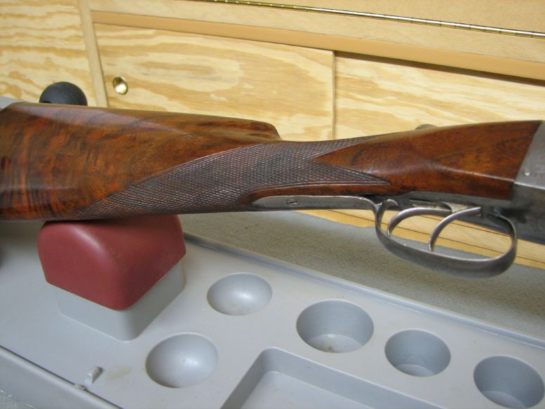

I have an early Fox B-grade with all matching numbers. My question is with the stock. It is a straight grip, however the tang does not extend rearward as far as other straight grip Fox guns I have seen. It also lacks checkering on the cheeks which I have noticed on a number of other B-grade Fox guns. This leads me to suspect that this gun stock is not factory original and has been restocked.
What say you? Please see factory letter and a couple of pics below.

At first glance, restocked & converted from a pistol grip to a straight grip using the original guard.

Also, it looks like a fairly large splice in the right cheek. Without better pictures it is hard to tell with any certainty but that long diagonal line looks like a piece of replacement wood may have been joined in to repair something that went wrong.

I agree with Kutter and ROMACs comments.
