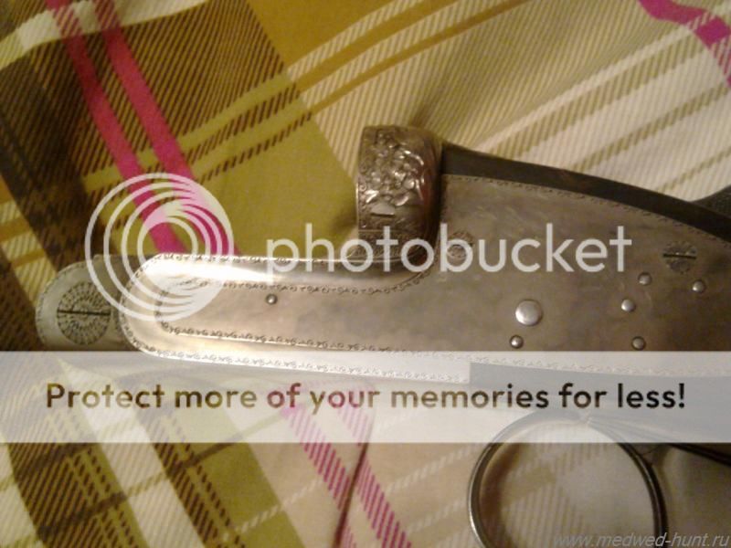

I am trying to find more info about a Belgium pair of shotguns? It has Belgium proof marks. It has no makers name. Can some one help me identify the maker of this pair. No 1 gun has Nitro proof written on the barrel in addition to the markings on No 2
It is a side plated boxlock, ejectors, 30" barrels and 16 ga.
Any help is appreciated,
Thanks

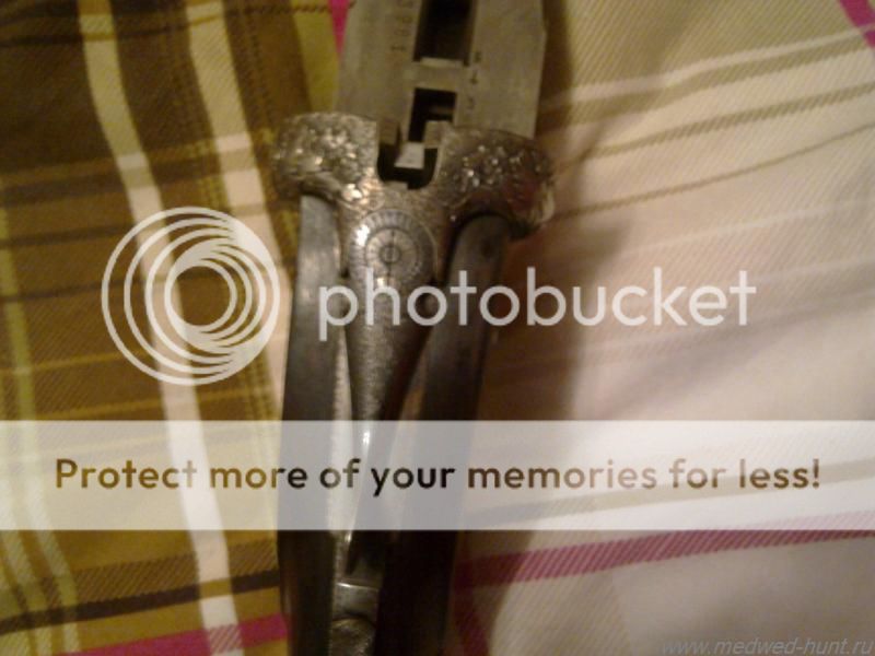

Some additional pics....

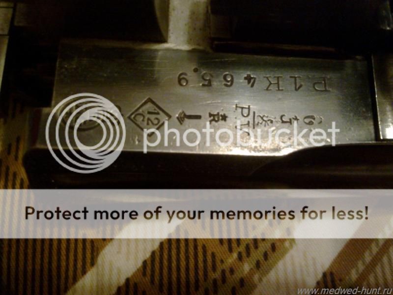

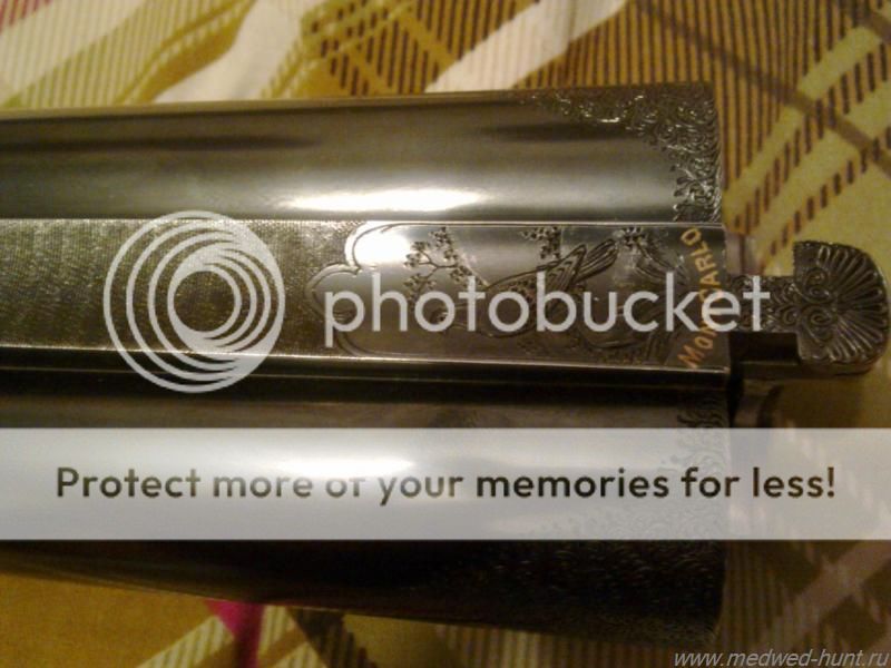

Pigeon guns maybe, given the "Monaco" on the rib and the bird on the trigger guard. 2 1/2" chambers, date code looks like 1928.
Can't help with a maker's name. Are you sure they're sideplated boxlocks? If so, they've gone to the trouble of showing a lot of false pins--but then so does V. Bernardelli, in its Roma series guns.
Great pictures of the proofmarks

It was proofed in 1928.
http://damascus-barrels.com/Belgian_All_Proofmarks.html
Andrew Jno. Hy. & Co. Ltd. Toledo steel works, Sheffield England, may be the source of the barrels.

Looking at pics this way and another, this could be a sideplated boxlock indeed, what with the action face being closer to triggers than on most sidelocks, and two screws on the trigger plate. But the lock plates are beautifully executed, it's hard to believe it's not a sidelock!

From the images, almost a zero chance of it being a sideplated boxlock. It is a bar action sidelock; count the which of what pins and pegs you fancy. It has the Purdey nose and side frame reinforcement but no sideclips. Interesting Sheffield Steel Works stamp. I do not think the tubes were sourced from England, but an ingot or bar stock may have been imported and the tubes made in Liege.

Names of Pigeon rings were advertised or used as models?

There are side clips and I also believe that it is a sideplated boxlock with fake pins. Some of them even have gearing that move the fake tumbler pivot.

Indeed, it does have sideclips. But I am just taken aback that all the pins would be faked? I guess the absence of the retaining screw on the right lock hints to a sideplated? I'd like to see the lockwork. Hum, sure not what it seems on the surface. I guess if a retailer would scrub off the marks, they would also fake the pins. Also the initials near the forend hanger look to be overstamped. If it is as stated, it needs to be added to the pin/peg thread.
