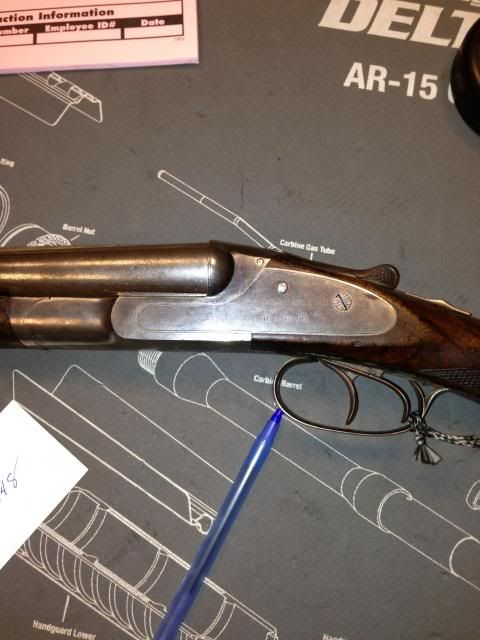

...is starting to make me wonder if I overlooked something. The barrel walls are not in line with the top edge of the breech face. Also, there is no noticeable gap between the barrel flat and the watertable. Is this Lefever or is something awry?
I haven't been back to see it in person and only have my phone pictures to assess.
Thank you!
Shoot straight,
Bird
10 gauge gun with 12 gauge barrels?
That's the likely reason. If so, the firing pins probably strike high on the primer.

Barrels are usually struck with them being on the frame/receiver. It is quite possible that these are another set of barrels.
I do not know much about Lefevers, but some double gun manufactures made different weight frames and so naturally the barrels would be different in the breech.

I have 12ga Lefevers weighing from 6˝ lbs to 8 lbs. I have at least 3 different pin spacing's as well as width & height of the standing breech. These could just as easily be a light weight set of barrels on a heavy weight frame as to be of a different gauge. One thing I think is pretty certain, they didn't leave the factory like that, not even an Ithaca assembled one.

Sorry to leave you hanging for the day.
Its a 20ga on a XX frame with damascus barrels. I could imagine a "re-gauged" if you told me 16ga were built on the XX frame. They were right?
Also, i could believe rebarreled if it currently sported steel barrels. Rebarreled to damascus?
Dolls head fit perfectly. I would call it on the heavier side with barrels and forend weighing just over 3lbs.
Intrrestingly enough the barrels are each stamped with different serial numbers that are off by one. Looked to be stamped by same tools.

My 16 gauige frame is marked XX. I have also heard of a few lightweight 12 gauge guns built on the XX frame, though I don't have one. My 16 on the XX frame weighs in at 6 3/4lbs while I have a 12ga not on the XX frame which only goes 6˝ lbs. The Bar of the frame is slightly slimmer on the 16 XX but the breech is a bit larger on the 12, though the barrel walls are thinner. Both are H grades with twist barrels. None of mine have a mis-match lik e that including this 12 which is a very late Ithaca gun which also has a mis-match on SN's from the frame to barrels (4 numbers apart).

With Lefever, I could see this being a totally original gun. A 20 gauge Damascus barrel is so scarce, I can't see it being a put together gun. Good doll's head and water table fit pretty much precludes a put together gun. Fire a couple of shells with primers in them to see if pins are centered on the chamber centers. We would like to see more of this gun. I would buy this gun. If you pass on this one, PM me the location.
