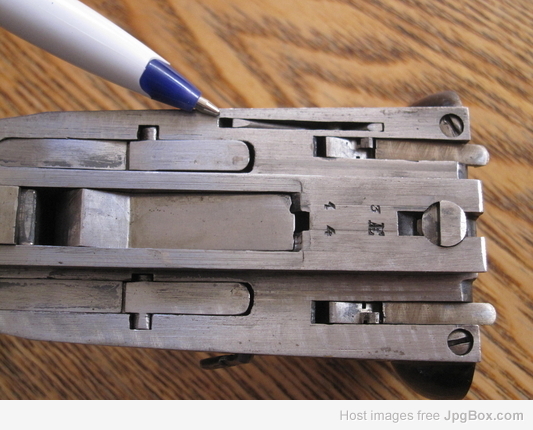

There were two styles of R safety mechanisms in the James Wayne era-a push button safety, and the more conventional rotating lever. The parts from these are not interchangable, and, of the two, the lever is the more secure and fool proof design. You haven't been clear about the exact problem, but, if the gun is a push button safety, and the button has rotated in the breech block, the safety will not work. It is a simple matter to remove the breech and inspect the retainer spring to see if it is riding on the flat of the safety button.

By way of illustration:
The photo shows the safety button spring on an R model Darne, in this case a rotating lever version. The pen is pointing to the end of the spring that must ride on the flat of the shaft of the safety button or lever. You may have to rotate the button to get that to happen. If one side of the safety button is larger than the other, rotate the large side clockwise, as the shaft is two pieces, and rotating counter-clockwise will result in the shaft coming apart. Don't use a vise grips to do that, mate.

The gun has the cross-bolt safety that protrudes from either the left or right side of the receiver. Pushed right-to-left, the protruding portion shows a red band, indicating the gun is ready to fire. Pushed left-to-right, it is supposed to be in "safe" mode. On a whim, I decided to give the safety a trial and was dismayed to see the bolt migrate from safe to live position in response to pressure on the front trigger, followed by a released firing pin. Not good!
Ted, are you saying that a simple rotation of the cross bolt might solve the problem? That would certainly worth a cautious try.

Bill,
Yes. I've seen this movie already.
Note the spring that the tip of the pen is pointing at. It may be necessary to lift this spring slightly, with a dental pick or similar tool, and rotate the red band end of the safety button clockwise, so the flat on the shaft of the safety button that the spring is supposed to be in contact with is in proper position. Have a helper, wearing a leather glove (the machined ends are quite sharp) hold/support the block while you attempt the manuever.

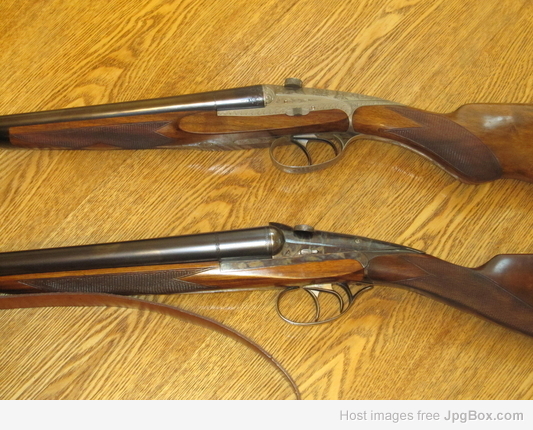

Billwolfe,
OK, so, what happened? I was hoping to hear you turned the little bugger a bit, and then went out and shot a limit of quail.
Anyway, best of luck with it. Here is a photo of the two that I own, an R10 model in 12 gauge, and a V19 in 28 gauge. I'll probably use the 12 tomorrow in Steele county, MN., in pursuit of ditch parrots.

Thanks for asking, Ted. I took the breech block off and fiddled with it a bit. I can see the flat of the cross bolt and where the safety spring should ride--it's not that far off, but I couldn't get enough purchase on the opposite end of the bolt to get it to rotate. I'll call Kirk on Monday and see if he'll take it on. A general strip/clean/lube/checkup seems like a good idea anyway.
