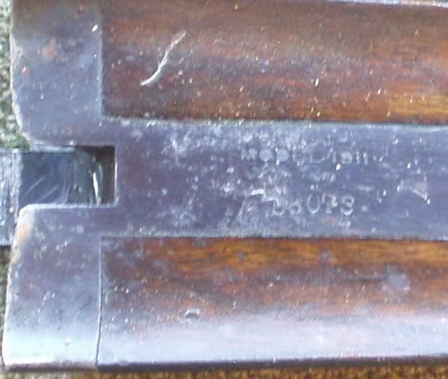

Here's a photo of the forearm iron. Sorry it is such bad photo. I think some dust got on the lens... However, you can see the MODEL 1911 stamp.
I beleive that the originall owner bought the gun new so the date of manufacture is important.
