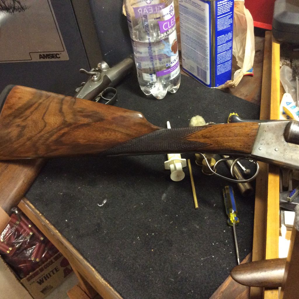

I had Cody/Keith Kearcher do a transplant on my 1915 Ithaca Flues 16 gauge. It transformed an unshootable family heirloom with 3" of DAH into a treasured shooter. It was a pistol grip and I had them build a straight grip to my much longer and higher dimensions, put on a pad and extend the tang. It was gone for just 2 weeks. No one can detect this. This is a fairly thin grip and I have hundreds and hundreds, if not a thousand, rounds through it. I would do this again without hesitation.

JNW - Looks perfect!
