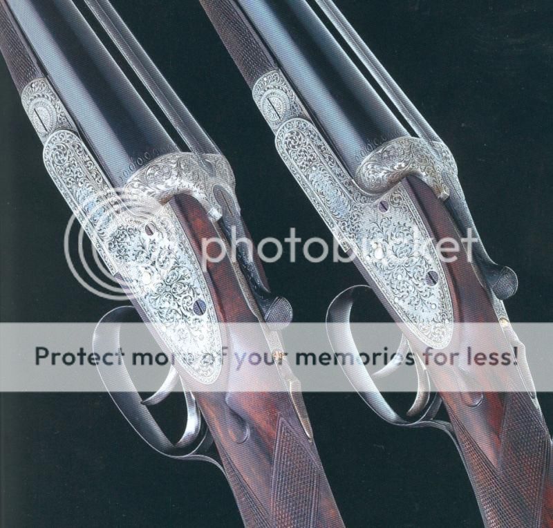

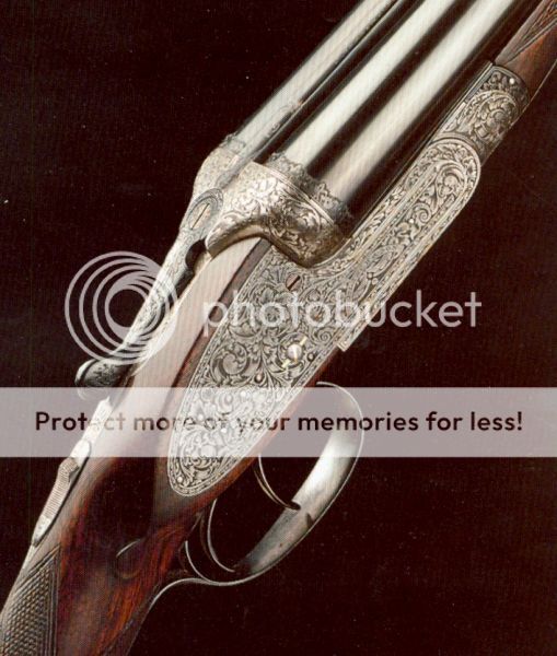

A quick search of the WWW netted these two images of some Webley with a horse-shoe toplever(maybe the interface of the topelever radius & frame?). Not sure what it means and may need to bring in a Brit.

from those pictures - i would guess it has to do with the horse shoe shaped area on the breech around the end of the top lever.
notice the notch to allow the lever to move to the side in the bottom pic
