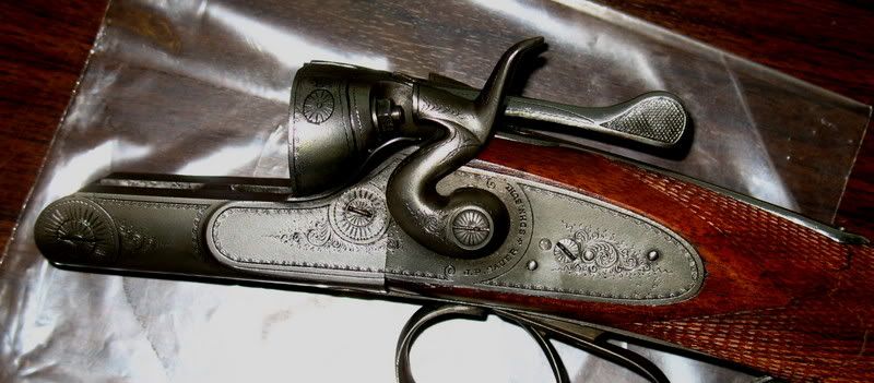

Eightbore, I added 2 pictures I took in my office this morning before packing the stock up for shipment. Lighting was not good, and poor background, but it shows the action. Is this considered a sidelock?

Posts: 2,307
Posts: 2,307
Yes, that's a sidelock gun. I have it's twin in 16 gauge.
