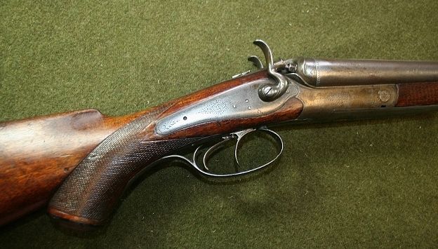

Hello,
I am a retired teacher and firearms enthusiast. I like old and unusal stuff. Dont mess with much that is Post WWII. I am primarily a researcher and guns are my favorite topic. I am not a dealer but I do help people when they get dad's guns and don't know what to do. Thus the reason I wound up here.
The Peterlongo Cape Gun appeared on my doorstep a week or so ago. I found out some stuff. It is black powder proofed. It has good bores and a tight action. It has double set triggers. The shotgun is 16 ga. chamber for 2 & 5/8. The rifle is 8mm X 72 Sauer. It is well used, most of metal finish is gone with a bit of plumb bluing scattered about and small amounts of faint case tither and yon. The wood has all the normal wear with a small chip on the fore end above the wedge, otherwise it is solid The strap is old and appears to have been with the gun a long time. Here is a link to pictures
http://s773.photobucket.com/user/twines12/library/Peterlongo?sort=2&page=1
(You may have to cut a paste.)
I am looking for specific information and best guesses at to value.
You can contact me direct at twines1@comcat.net
Thanks
Tom the New Guy

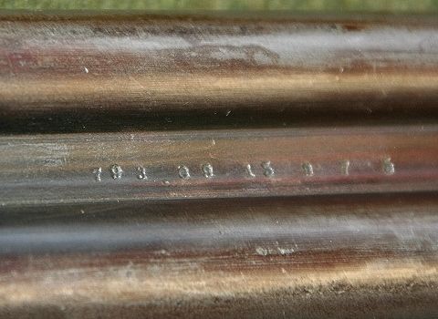

1st pass thru Ferlach proof - 793.09.15'8.7'5 - Nr. 793 for 1909 with one tube diameter being 15.8mm & the other 7.5mm.
Final pass was in 1911.

Simple Ferlach field grade "cape" gun intended for hunters of modest means. Peterlongo was one of the largest Austro-Hungarian gun dealers who sold many firearms by mail-order all over the Dual Empire and beyond. Here in Central Europe such guns are relatively inexpensive. A rather interesting and nice classic nevertheless.
With kind regards,
Jani

Thanks for all the great responses. I gather this gun was built by his son 10 years or so after the Sr. Peterlongo past. I understand some of the information on the coding, the tube size, and the year date 09. I don't get the the 793 or how 1911 is the second pass through. I am still looking for best opinions on value.
Thanks again.
Tom

This gun was not built by the Peterlongo firm, but sold by them. Peterlongo bought it from Ferlach gunmakers, for resale.
Kind regards,
Jani

The final pass to complete the process was in 1911 & this example was assigned nr. 793 for the year 1911. They would assign numbers to make the sporting weapon anonymous to prevent bias to a specific maker(s).
