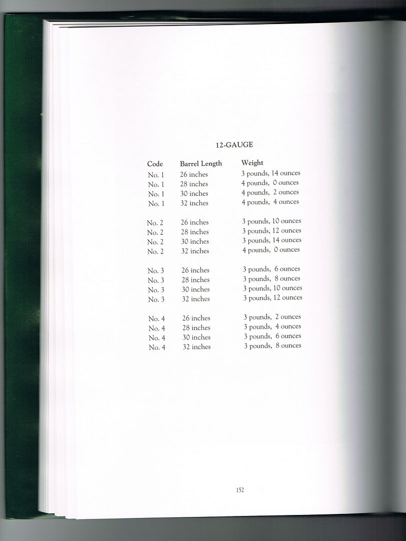

Is there a resource, such as Mcintosh's book, to identify what weight barrels a particular forend was intended? I mean by measurements. Or was it not even close to being similar as they rolled out?
How would I identify the barrel weight without the stamp? A weight range?

The McIntosh book sets out the weight range in conjunction with the numbers. Maybe someone has their copy of the book handy...Geo

Such a weight chart would no more predict fore end size than ladies weight would predict bra size. Fore ends were fit from a rough inlet blank to fit the guns final barrel shape after striking. You might find a used one and get it to fit with a little alteration. But it is all luck and chance given that you need to find a old one close to your needs.

The barrel weight numbers do not necessarily correspond to the weight of the finished barrels, only the weight of the raw tubes.
Imagine this, a customer orders a gun and orders it to be a specific weight, since the barrels make up a good portion of that weight, the factory man would pull the appropriate weight tubes from stock for the intended finished weight of the barrels.
I doubt that any two barrel sets of the same number would weigh exactly the same.

Here is the 12 Gauge barrel weight chart. Remember these weights are as unfinished barrels.
