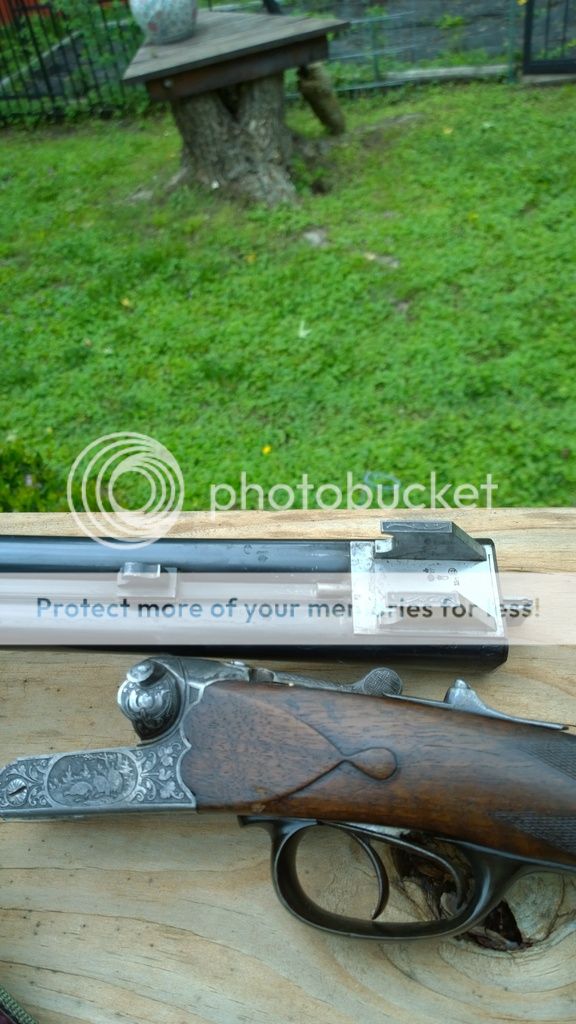

here is a 12 ga shotgun (Franz Jager)It is marked as a Simson Jager Patent. the double lumps are supposed to prevent side to side movement under heavy recoil and the push button where you would normally see a safety actually uncocks the mainspring. both these features are intended for double rifles according to the makers grandson. maybe solutions for non existent problems but interesting, I also just picked up a nice 16 ga Mich Pegam Ferlach SXS that has a flip up rear sight maybe for use with slugs?

Notice the size of the hinge "pins"(actually lugs). Since they are larger, they allow the gun to stay "on face" longer, and the location, at the sides, allows a shallower action( if on a drilling, even more so). The separate cocking is a concept used on more and more modern guns, because it allows them to be carried with complete safety, even loaded.

Mike I believe your correct. Supposedly this type of action allowed hunters in Africa to keep loaded guns in the truck safely. Cocking the mainspring is not very difficult and can be done as quickly as pushing off a safety. It is a very light 12 bore, very well fitted and put together as are most German guns. even as a medium grade gun .

It looks like it has now common safety-cocking-decicking mechanism which is neat.
As long as sliding motion is not hard to initiate that is a positive thing. It is kind of hard to move on some guns like the state of the art Sauer 404.

Jagermeister, I am with you: hard to move thumb cocking pieces are the reason I do not like modern "safety" guns (such as Sauer 404, etc.).

GMCS, I hope you will also show us your Mich Pegam Ferlach SXS that has a flip up rear sight. I suspect it could be meant for sniping long distance smaller fauna such as hare and fox (with shot).
