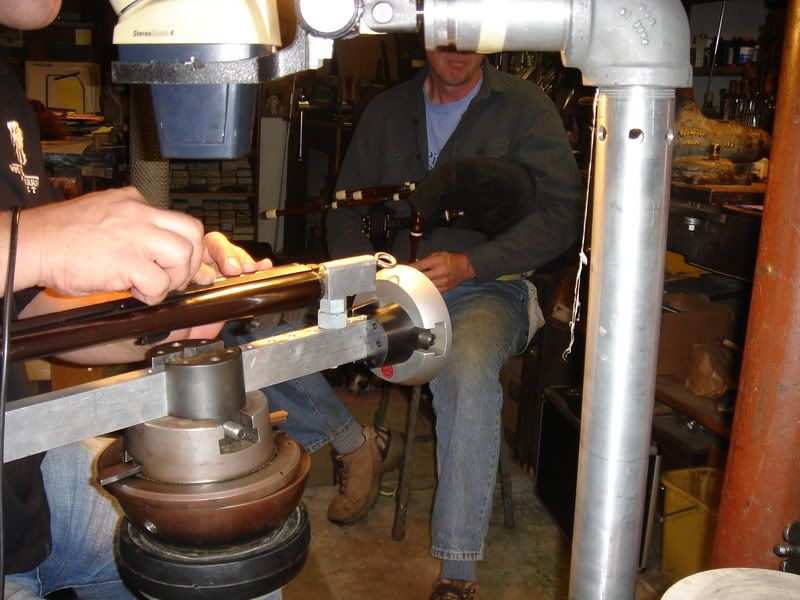

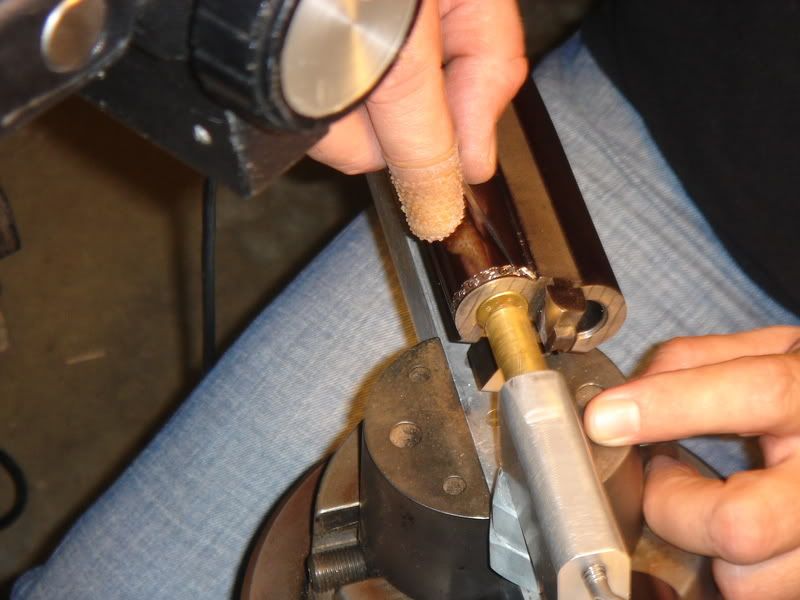

Speaking of Gibbs Double Rifles, this is a shot of Hands' hands working on the scroll border at the breech end of a set of .450 nitro bbls. Not an easy item to swing, but with a little help from my aluminum bbl holding jig, it is manageable. Besides the scroll there were one hundred and nine letters.
All the best,
Barry Lee Hands

The pipes were calling as the Gibbs address was reapplied.

I understand bowling balls can make great vise mounts when set into something (like a sandbag of lead or sand). About the time I read that I happened to find a bowling ball in my alley right outside my gate. This was surprising as I can't imagine Puerto Ricans bowling. I said to myself that I could always use something like that for the mass and material. I left it there and latere realized I should have taken it in. Even for non-engraving work it's a good vise mount. I'll have to find one at a resale shop somewhere.

If you find such a ball , after mounting vice, remove same. Drill large oles into ball & fill with lead bird shot --- seal over holes with accra glass. This will give you a ball that won't easily tip or tilt over when working with it. FWIW, Ken
