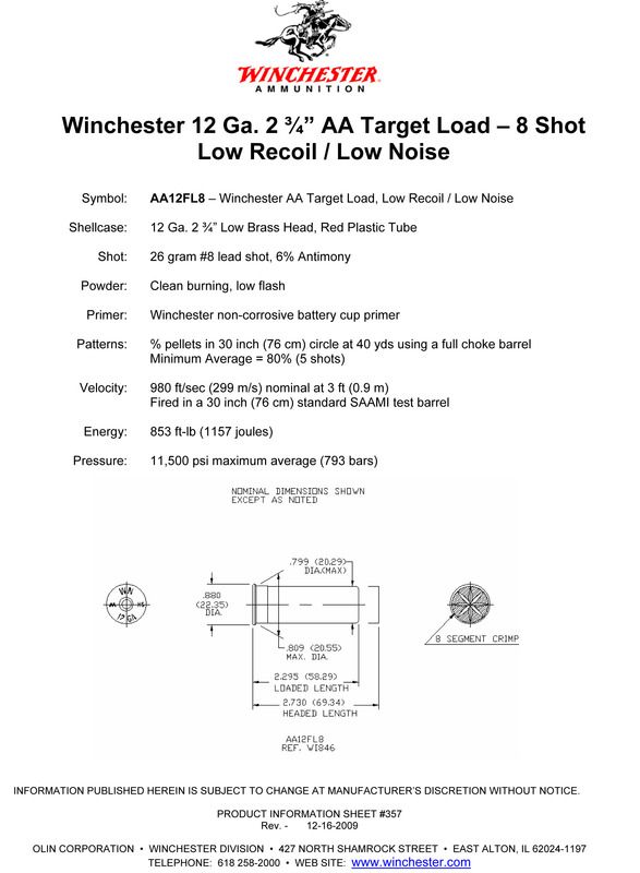

This is how Winchester protects their butt as to pressure.
The load above is very close if not the same as the load on the Hodgdon site.
Manufacturer Powder Primer Wad Grs. Pressure Vel. (ft/s) Velocity:
Winchester WAALite Win. 209 WAA12SL 12.0 5,600 PSI 980
