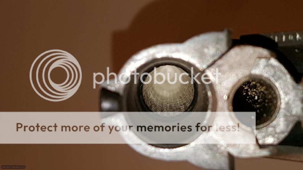

This O/U Combo is a bit tattered but the Feinster Special Stahl tube does have the Sigott-Drall-Rifled-Bohrung and might be worth consideration just to see what the pattern might yield.

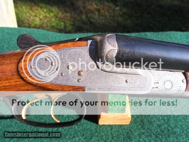

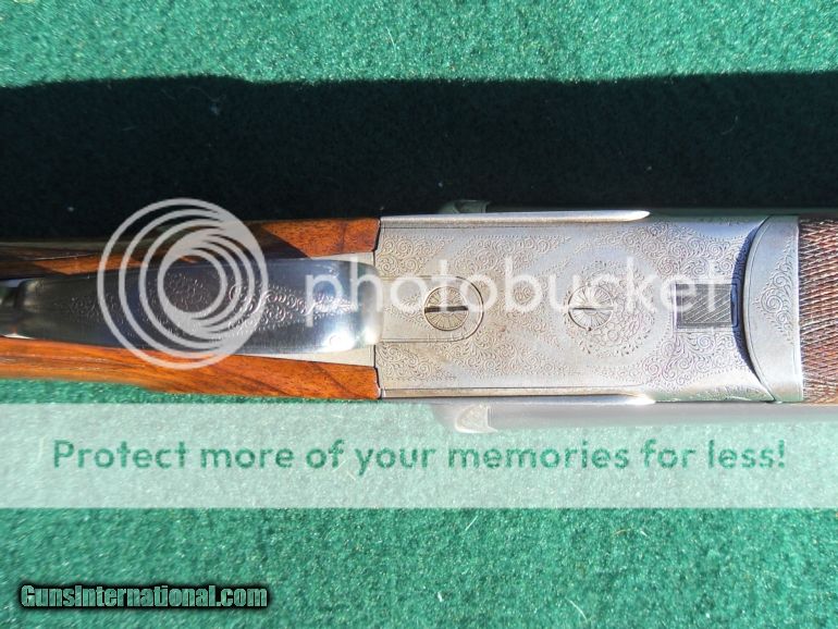

For those following along, I'm confident this offering is an A&D Body Action w/ false sideplates:
http://www.gunsinternational.com/guns-fo...un_id=100495450
Another Johann Sigott false sideplate from a previous thread:
http://www.doublegunshop.com/forums/ubbthreads.php?ubb=showflat&Number=370702&page=3
With only 2 such Johann Sigott examples, I'm curious if all the A&D Body Action w/ false sideplates were sourced from Liege?
