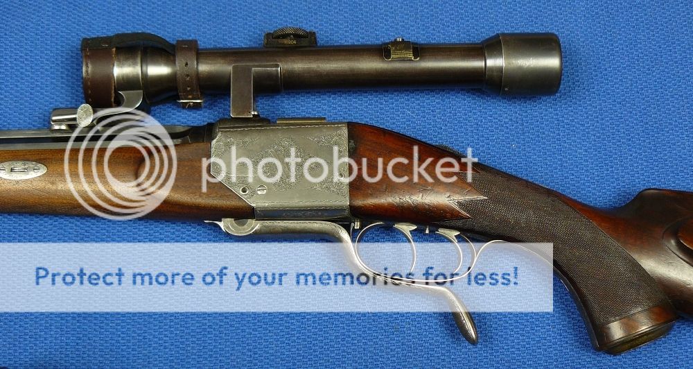

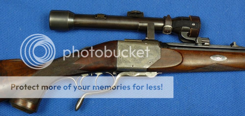

Sounds like a Johann Kalezky? Does it resemble this:
http://i697.photobucket.com/albums/vv337...zpsd2rxoon4.jpg
http://s697.photobucket.com/user/ellenbr...rxoon4.jpg.html
Forward the images to me & I'll get them in view.

http://i697.photobucket.com/albums/vv337...zpsprnjkmk7.jpg
http://s697.photobucket.com/user/ellenbr...njkmk7.jpg.html
Let me know if this cannot be viewed. It seems that Photobucket is attempting to block the direct link also? It appears if you do not have a Photobucket account or are not logged-in that you cannot view the image.

Yeah, I think those w/ a Photobucket account can see. Also yes it is the Alex Henry / Johann Kalezky type action. I'll put these on my Photobucket account and will forward any image if that is allowed or permission granted?
