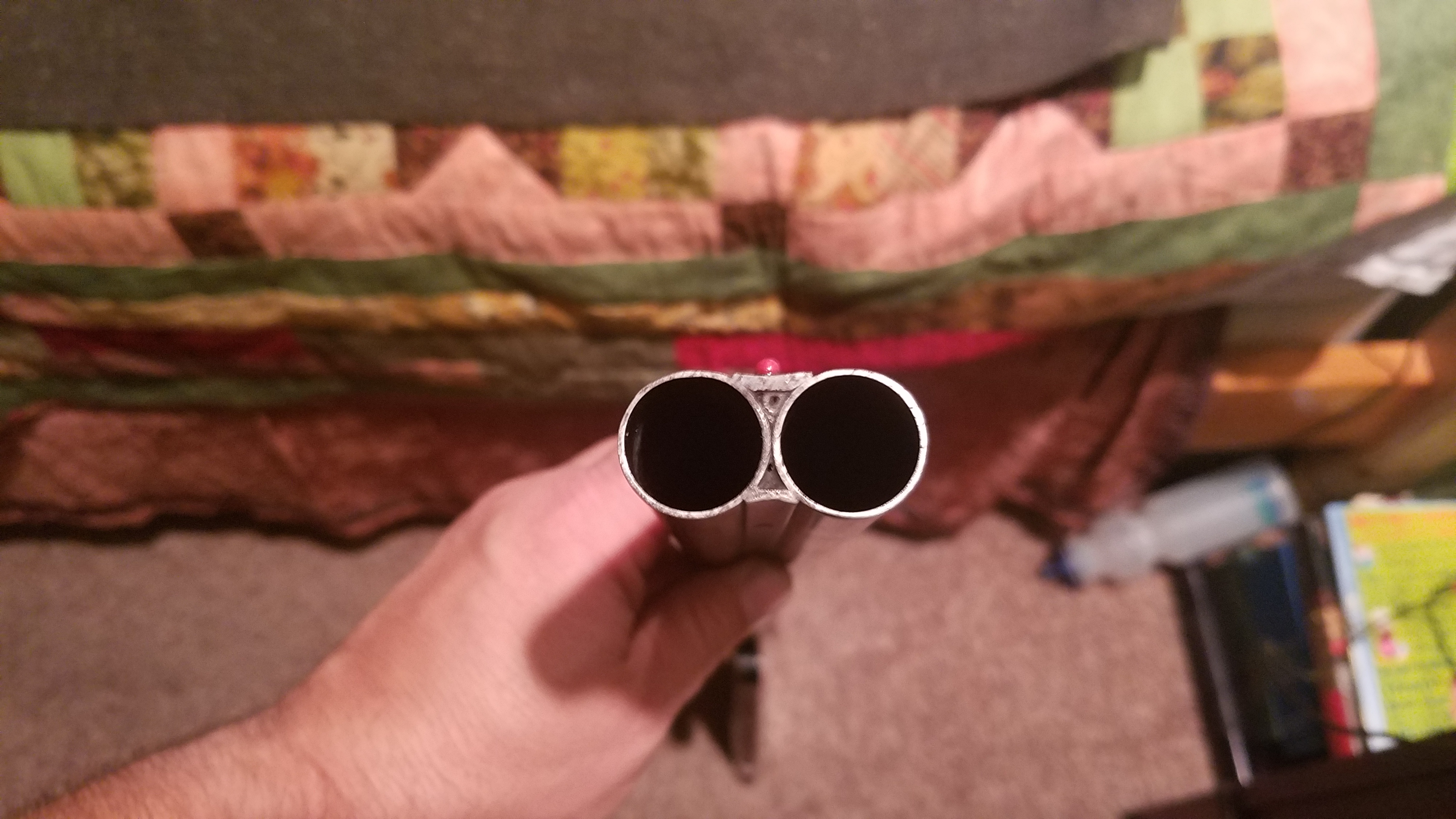

Hello,
To cut to the chase, what is the best option to 'permanently' plug the 'key' areas under the rib on a 12g SxS that was cut down?
My goal is to keep the firearm as a reliable shooter, which, to me, probably means less thand 400 rounds through it a year- and closer to 200.
In my ignorance, I picked up a Parker Trojan from 1916 that I now am darned sure was cut down.
There are openings at the muzzle end that match the images I've seen.
Also, measuring the bore gives a choke of IC [R] and C [L] for the barrels, which doesn't make sense to me, unless the barrel was cut back and this is the remainder of the bore constriction going toward a Full [r] and a Modified [L].
I don't want to 'restore' the shotgun. I simply want it to work very well, for a long time. Beauty is not paramount, but is relevant.
I am not a fan of the JB Weld approach as a filler/bonder/sealant to this key area, but I could possibly live with it- maybe.
I'm hoping there is a decent SxS gunsmith that I could ship the barrels to and they could simply do their magic to install/solder keys into those blanks, and in my fantasy I hear a price of under $200 whispered back to me.
I am in a realm of fantasty, I know.
Any suggestions?

Easy fix, I can solder New keels in for you.

Brownell's used to sell powdered steel that was great mixed with JB Weld for this kind of fix. Very strong and looked correct. Steve will make it near perfect.

The gun would have been just fine to shoot as is.

Probably. But, it will look finished at the muzzles when it is done. I know how the OP feels, looking at a poorly finished barrel end is like having a pretty girl with a piece of cabbage stuck between her front teeth at the dance.

Cut barrels wouldn't explain why you have more choke in the R one than the L after they've been shortened. Still should be more open R, tighter L . . . if you have any choke at all remaining.
