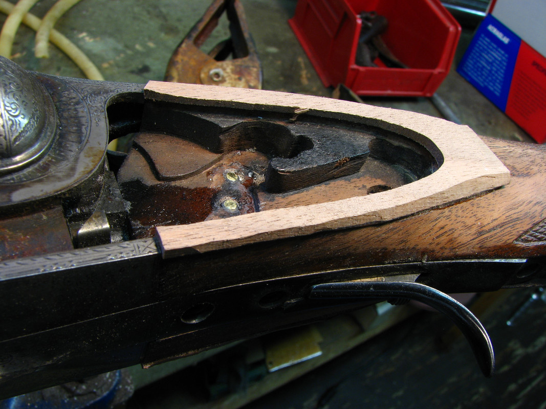

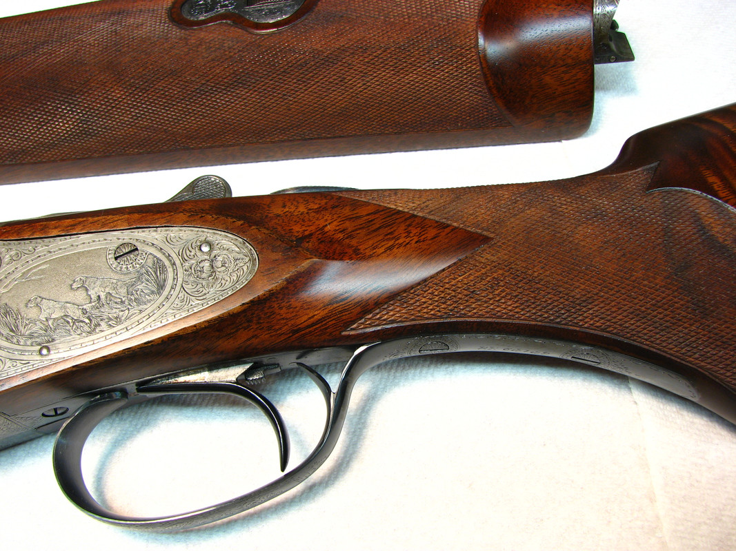

Here's an example of a repair done by the extremely talented Pa. Gunsmith Dewey Vicknair on an L.C. Smith. This technique might come in handy to repair the frequently seen broken wood around the sideplates on Syracuse Lefevers. It shows what is possible, but not a good job for a beginner to attempt to tackle.

I'll second that "talented gunsmith in PA,". He can work wonders. Look at his blog and website before you attempt this yourself.
