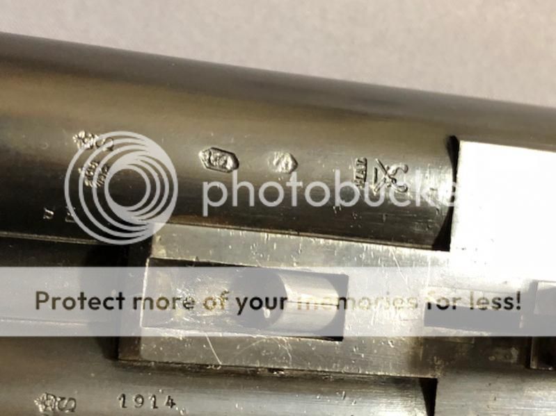

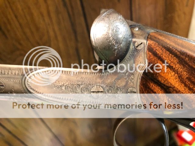

My Charles Daly Linder 10 b SXS has serial number 1668. It has ejectors and appears to have been restocked. Weight 9.25 lb Krupp fluid steel barrels 30 inches. There is a number on the barrels 1914 (date of make?) in addition to Prussia and crossed pistols.
Question when was this Linder shotgun made, model number?

If it wears the Lindner quality control stamp of Cross Pistols surmounted by a Crown or HAL, then it would indeed be a Lindner-Daly. Images would point to the modell number.

Photos are posted on the German Gun Collectors site- Prussian Daly Section.

http://www.germanguns.com/upload/showthread.php?1959-Daly-Linder-10-b-S-X-S&p=13340#post13340
Yeah, 2nd series Lindner - Daly. Schilling Forge tubes and the 1914 is a barrel number.

What if the stamp is crossed pistols without the HAL? What does that tell about origin? I have a 12g Daly (SSN 2851) w crossed pistols beneath a crown but no HAL or Prussia stamp. Thanks for the information.
Pre 1893 I believe.

It wouldn't be pre 1893, it has proof marks that were not used until early 1893- crown "S".

Ford, they aren't discussing the subject longarm.
Y85, either post or forward me an image of the marks.
