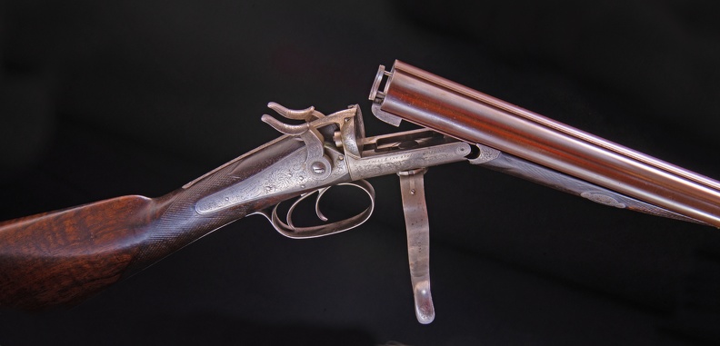

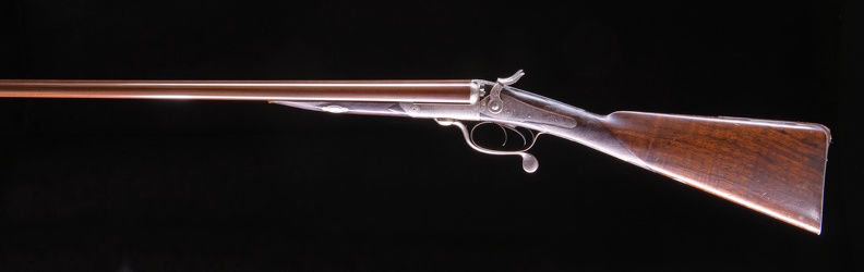

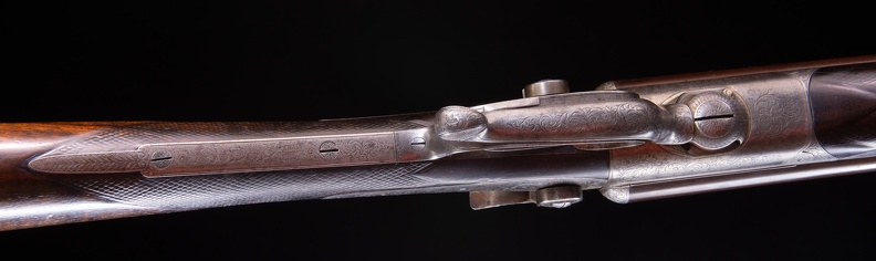

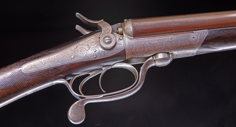

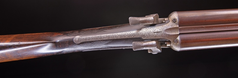

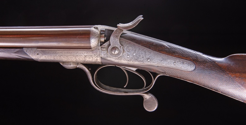

My wife just acquired an 1860 Charles Lancaster in 14 gauge, with the sliding breech underlever mechanism.
What would be the correct label for that era, when I fit out a case for it?

151 New Bond Street on the rib. It dates from 1860. I have that information. There are several labels with that address. Some are as late as the 1890s. I'm finding less information on these than I did for my Westley Richards.
