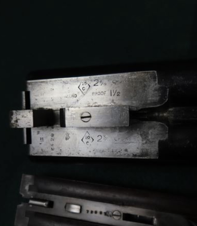

Saw a 10 gauge W.W Greener online, the lot description says 2 3/4 “ chambers. Pictures showing the proofs and chokes show 2 3/4. I have never heard of a 10g 2 3/4 .The gun looks great , but is it a brass shell gun? I thought the tens where 2 7/8? Experts please explain.

It Could be any number of things,guns can be prooved in @ 1/8" increments. I Have in fact seen 2&5/8" proof marks on a top tier London 12 ga. So here goes.
1. Meant to be 2&7/8" but reamer was a little undersize so marked as 2&3/4"
2.Mis Marked at proof.
3.Actually Built as 2&3/4" per customers request.
various others

https://i.postimg.cc/MpLk8642/B3-B775-F2-732-B-46-AF-8-BF5-A03-F2-DB11-BEE.jpg
Here is a link to the pic with proofs.
They say it’s a depression era gun.
Serial is correct for that.

Just unsure because of the chamber stamps.

i have examined a "not for ball" (pre 1888?) marked boxlock 10 gauge, originally stamped with 10 in the diamond - which i interpreted as standard 2 5/8 chambers. it had made another trip to b'ham under the 1925 rules and was stamped as 3 1/4"....to the best of my knowledge, the longest english 10 ga chambering - prior to the 3 1/2" american magnum.
the gun in question does not appear to me to be an FP action....looks similar to an empire action, but realizing that cannot be the case, i will go with parabola's proposal - that is an a & d gun from the lean years of the great depression.
