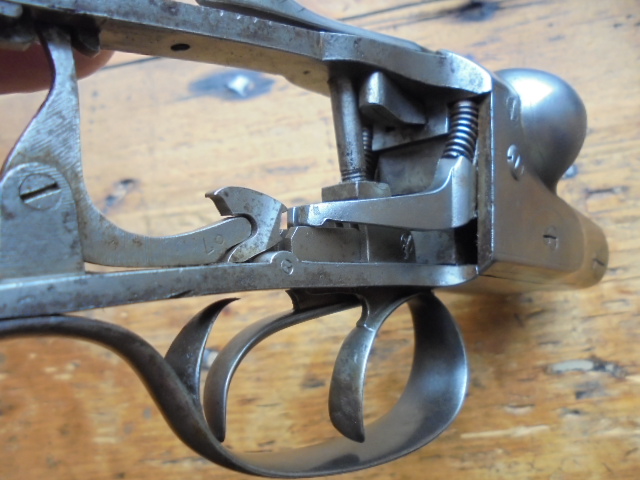

I just got my first Sauer from the last Holts sale for about $60.00. Its clearly had a life but seems to be mechanically sound, its one of a large batch of guns which came from a Danish collector in the auction. The strip down has been fairly straightforward but I've come to a halt at the hanging sears. Can anyone advise on the correct way to release and remove these. I'm guessing that the tumblers are similar to any boxlock when dismantling

If you haven't got any joy just yet, be sure to release the force by dropping the hammers taking the tension off the scears. The overhanging scears will need to be removed before the tumblers can be compressed and rolled out. Gently slack up the overhanging scear pin quite slowly and remove it taking the tension off by lowering it. Typically in European sporting weapons the mark usually go on the right side. Be sure, be very sure to note, take a tonne of fotos, whatever exactly how the spring guide is oriented as it must be returned in the exact same position.

Thank you for your reply. My main concern was the strength of the coil springs which "tension" the sears. When I remove the pivot pin it feels as if it will be very difficult to relocate them when re-assembling everything because of this. Is it normal to have such strong springs ? I wondered if a previous owner had preferred a stiff trigger release and had replaced them.

I did lower the hammers at the start of things and the sears move freely, but with some effort as the coil springs shown in the one image I have managed to upload are pretty strong, hence my concern about removing the pivot pin.

Well, that was much more straightforward than I imagined it would be. By carefully pushing in the correct upward direction, shielding my thumb with a small square of leather on the painfully shaped sear arm the tension on the pivot pin was slackened and it all came apart easily. The mainspring was compressed with a trusty piece of yew wood with a "V" in the end and the tumbler pivot pin was released and removed. It looks like the small connecting piece between the tumbler and the cocking indicator is missing but I can live with that. Everything was in tidy condition and just needed cleaning and polishing before re assembling and repeating the process on the other side. Whilst I was in the vicinity I dismantled the top lever, its pivot shaft, the bolt and the Greener/Kirsten assembly, cleaned everything and popped it back where it came from.
