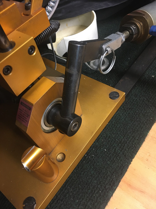

“ With my Spolar I had the hydraulic cylinder adjusted so the shaft traveled too far by about 1/4" which caused me to over-seat the primer if I stayed at the bottom of the cycle too long.”
KY Jon,
Not sure if I understand adjusting the hydraulic ram travel for primer seating depth. Are you using the ram stop collar for seating depth?
I’ve switched between Gun Clubs and Nitros with no primer seating depth issues. I’m still using the old style primer seater design.
Ken
